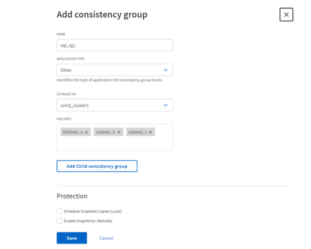

First, set up a consistency group for all volumes that host database files:

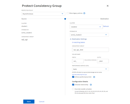

 Then, protect it to secondary storage:

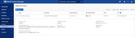

After replication is set up, check the status from ONTAP System Manager:

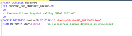

In Microsoft SQL Server 2022, a new feature was introduced: a database administrator can quiesce and unquiesce a database by using a T-SQL command. Between these commands, administrators can use the ONTAP REST API to trigger a volume Snapshot copy. Irrespective of database size in gigabytes or terabytes, a volume Snapshot copy can be executed in a few seconds and deliver an application-consistent database backup.
These NetApp Snapshot copies are then replicated to destination storage in case data needs to be recovered using a Snapshot copy at the secondary site.
The following screenshot shows quiescing of a database with a T-SQL command. Multiple databases can also be quiesced in a single command. After the I/O is frozen, you can quickly trigger consistency group Snapshot copies by using a Windows PowerShell script that can call the ONTAP REST API. You then complete the operation by executing the backup command that will record the backup in the SQL Server system table and unfreeze the database.
