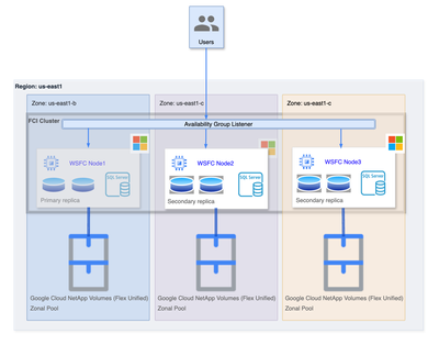

The Always On Availability Groups (AOAG) Architecture
The AOAG architecture consists of multiple SQL server instances that need to replicate their data to separate LUNs to maintain high availability. One instance maintains read/write and the other instances are read-only. When the primary instance has a change to its data, MSSQL must replicate the change to all the read-only instances. If the primary read/write instance fails, one of the read-only instances becomes the primary.
Why organizations  choose FCI on GCNV
While maintaining high availability, the AOAG architecture requires several copies of the same volume, thereby increasing storage costs. MSSQL replication must also be configured to all the other read-only instances, which requires expensive MSSQL Enterprise licensing. Additionally, to achieve required performance to the database, very often larger compute instances than required by MSSQL need to be deployed to avoid a hypervisor bottleneck. The larger compute instances then cause the MSSQL Enterprise license costs to increase even further.
However, enterprises  adopting FCI with iSCSI shared storage on Google Cloud NetApp Volumes obtain high availability all while simplifying the architecture and drastically saving on costs. Since the databases do not need to be replicated among several MSSQL instances, enterprises with the FCI architecture can save on storage costs, and can deploy the less expensive SQL Server Standard licenses. They can also right size their VMs to precisely only what MSSQL needs - knowing that network performance is not affected by VM size. This results in a large cost savings as seen at Cut SQL Server Costs by up to 50% with Google Cloud NetApp Volumes  . As a bonus, we can let the storage layer handle backups and disaster recovery lowering CPU usage on the VMs.

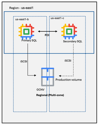

Deploying SQL Server FCI with GCNV Regional iSCSI Volumes
The following steps are required to deploy the FCI Architecture in Google Cloud with Google Cloud NetApp Volumes
  1. Create a GCNV Flex Unified Regional storage pool.
  2. Provision multiple LUNs for Data, Log, TempDB, and Quorum.
  3. Attach the LUNs to both SQL nodes using Windows iSCSI initiator.
  4. Create a Windows Failover Cluster with the required Windows Servers.
  5. Add the disks to WSFC.
  6. Install SQL Server FCI and point storage paths to the shared GCNV LUNs.
These steps mirror traditional on‑prem SAN design, minimizing change and easing migrations of existing SQL deployments.

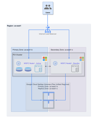

Protect SQL Server FCI from Zonal Failures on Google Cloud with Regional Pools
One of the most powerful high‑availability features for SQL Server FCI deployments on Google Cloud NetApp Volumes is the use of Regional storage pools. These types of pools replicate data synchronously across two independent zones within a region, ensuring that shared block storage remains available even if an entire zone goes down. They deliver  99.99% availability for shared LUNs. This matches the expectations for mission‑critical applications requiring High Availability. Regional pools can be provisioned with independent capacity, throughput (up to 5,120 MiB/s), and IOPS (up to 160k IOPS). Volumes used for databases are deployed within the pools.
Since Regional GCNV pools protect the database against a zonal failure, the WSFC nodes are intentionally deployed so that the primary WSFC node resides in the same zone as the primary GCNV pool, while the standby WSFC node is placed in the replica zone. This ensures that SQL Server FCI has consistent shared block storage accessible from both nodes across the two zones.
This design directly complements Windows Server Failover Clustering, enabling fully automated failover with no manual intervention, even during zonal outages. Let’s go through an example.
Deploying MSSQL across zones
Let’s take a concrete example:
  • Regional storage pool:
    Replicated across us‑east1‑b and us‑east1‑c
  • WSFC cluster configuration:
    • SQL Node 1 in us‑east1‑b
    • SQL Node 2 in us‑east1‑c
GCNV synchronously mirrors storage blocks between these two zones, so both nodes see the same shared iSCSI LUNs at all times.
Normal Operation (Both Zones Healthy)
When both zones are available:
  1. The WSFC SQL node in us‑east1‑b typically acts as the active node, hosting the SQL Server FCI instance.
  2. All read/write I/O operations are served from the Regional storage pool, with synchronous writes mirrored to the secondary zone.
  3. Latency remains low because both zones are in the same region and are engineered for synchronous durability.
This matches the expected behaviour of on‑prem SANs providing dual‑controller synchronous mirroring — except now it’s cloud‑native.
Zonal Failure Scenario and Automatic Failover
If us‑east1‑b experiences a zonal outage due to infrastructure, networking, or power disruptions, the following will occur on the storage layer:
  • The Regional pool continues operating from the surviving zone (us‑east1‑c).
  • Because the storage is synchronously replicated, there is no data loss.
  • LUNs remain fully available to SQL Node 2.
Google Cloud NetApp Volumes Regional pools are specifically built to ensure availability during zonal failure events. But what happens to the compute (Windows Server Failover Cluster) layer?
  • The WSFC cluster detects that Node 1 in us‑east1‑b is unreachable.
  • WSFC automatically triggers a failover to SQL Node 2 in us‑east1‑c, bringing the SQL Server FCI instance online.
  • No storage remapping or manual recovery is required — the LUNs are already visible and consistent.
Access to the database, both compute and storage layers, is maintained throughout the zonal failover process. This is exactly how customers expect SQL FCI to behave on‑prem — and it now works the same way in Google Cloud.

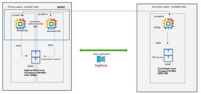

Cross‑Region DR for SQL Server: Replicating to a Standalone SQL VM
GCNV supports SnapMirror‑based cross‑region replication, allowing SQL Server databases stored on iSCSI LUNs to be replicated asynchronously to another Google Cloud region.
Replication schedules include every 10 minutes for low‑RPO DR.
How DR Works
  1. Primary region hosts SQL FCI on Regional GCNV iSCSI volumes.
  2. SnapMirror replicates the storage volumes to a secondary region. (Destination volumes are read‑only during replication.)
  3. A standalone SQL Server instance in the DR region mounts the replicated LUNs post‑failover.
  4. For DR testing, the read‑only DR copy can be used safely without affecting the source.
This architecture provides:
  • Low RPO (10 minutes)
  • Fast RTO with pre‑provisioned SQL instance
  • No need for AGs or extra SQL licensing
  • Multi‑region failover capability
