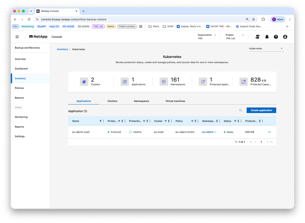

The Alpine app is already protected in Backup and Recovery as application pu-alpine-ocp2 with a protection policy.

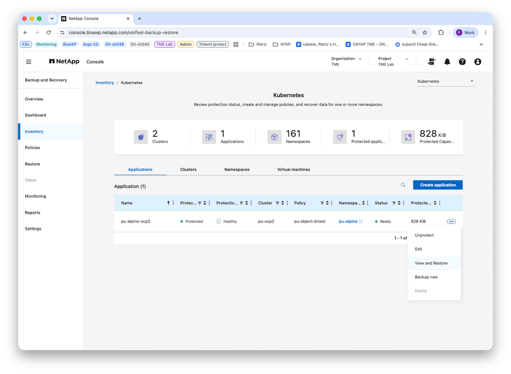

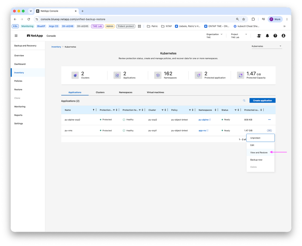

Let’s start a restore in the usual way be selecting View and Restore from the Actions menu to the right of the application in Inventory.

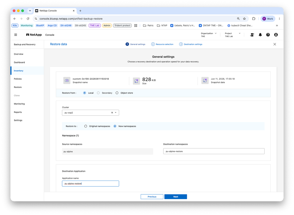

We pick the latest restore point from the list to restore from and fill in the restore details in the General settings screen:

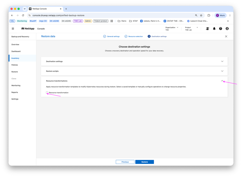

In the destination settings screen, expand the Resource transformations section and enable Resource transformation:

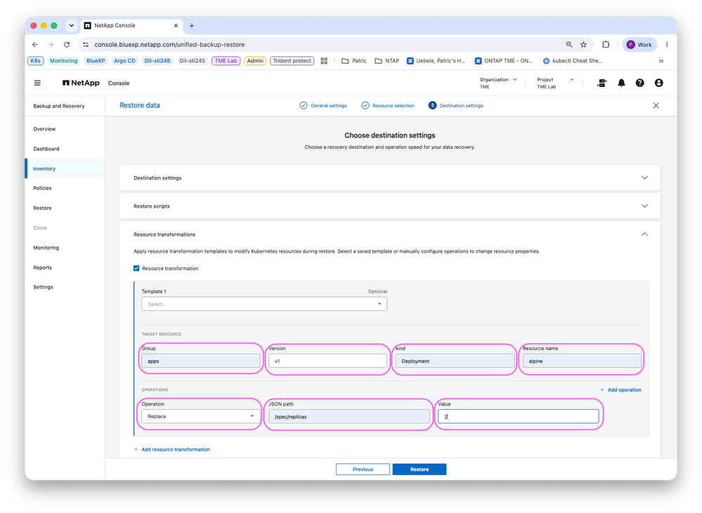

We don’t select a template yet and specify which resource we want to modify by entering the resource group, version, kind, and name.
To scale up the Alpine application’s deployment from one to two replicas during the restore, the target resource is determined by entering these values in the respective fields:
  • Group: apps
  • Version: v1
  • Kind: Deployment
  • Resource name: alpine
As we want to replace the value for the number of replicas, we enter/select in the Operations section:
  • Operation: Replace
  • JSON path: /spec/replicas
  • Value: 2
After selecting Restore, the restore process finishes in a couple of minutes and we can confirm that the deployment of the restored Alpine application in the pu-alpine-restore namespace was indeed scaled up to two replicas:

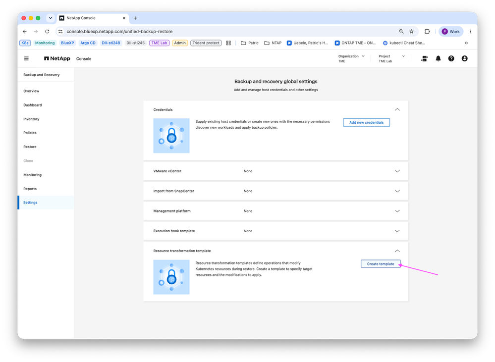

Resource transformation templates make the use of resource transformation even more easy and reproducible. We’ll show you how to create a template for the post-restore rescale operation we did in the previous section.

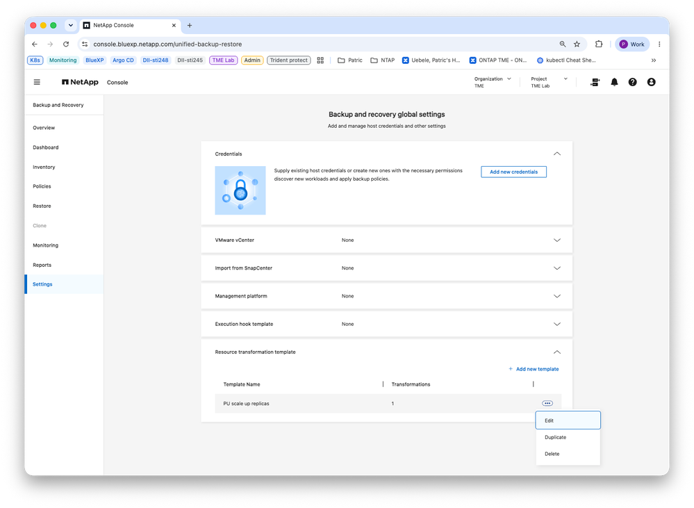

To create a resource transformation template, go to Settings in Backup and Recovery, expand the Resource transformation template section, and click Create template:

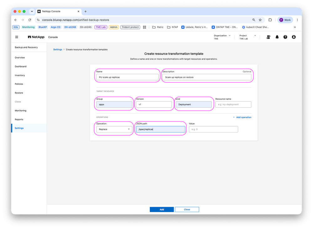

In the next screen, we name the template and add an optional description. Then we fill in the values for Group, Version, and Kind (app, v1, Deployment), leaving the Resource name empty, as we want the name of the deployment be entered when using the template.
In the Operations section of the form, select the Operation (Replace) and enter the JSON path (/spec/replicas), leaving the Value field empty for later population.
Clicking Add will add the new template to the list of available templates, from where we could edit, delete, or duplicate the template from its Actions menu.

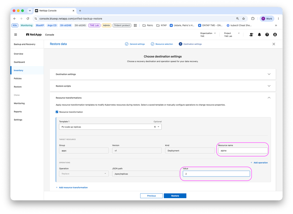

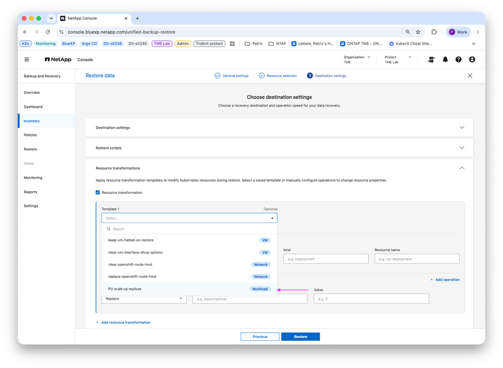

In the restore process, we now select the PU scale up replicas template we just created from the list of available templates (we’ll cover the predefined templates in the list later):
We now need only to fill in the values for the Resource name (alpine) and the Value (2) for the number of replicas we want to have after the restore.
After the restore finishes, we confirm that the deployment alpine was scaled up to two replicas:

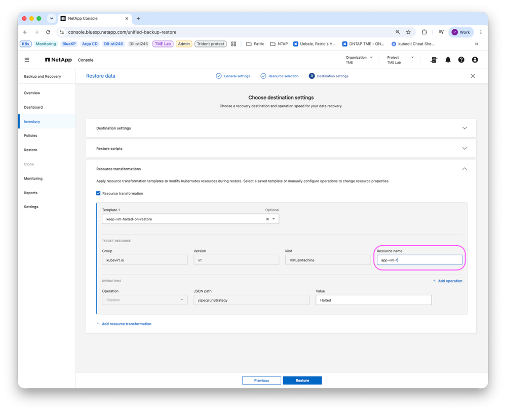

Virtual machine restores with transformation templates

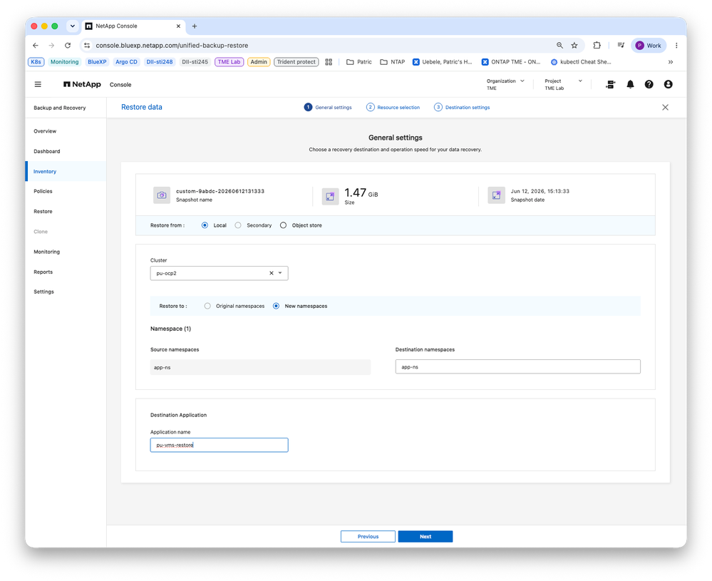

Now let’s have a look at how we can use one of the predefined resource transformation templates with restores of virtual machines. We want to restore a virtual machine from an existing recovery point to another cluster and don’t start the VM but keep it in the Stopped state. For this purpose, we can use the predefined keep-vm-halted-on-restore template.
We have a virtual machine app pu-vms containing the VM app-vm-1 on the pu-ocp1 cluster that we want to restore to the pu-ocp2 cluster without starting the VM.
After selecting the restore point to restore from we fill in the parameters to restore to the pu-ocp2 cluster and destination namespace and application name:

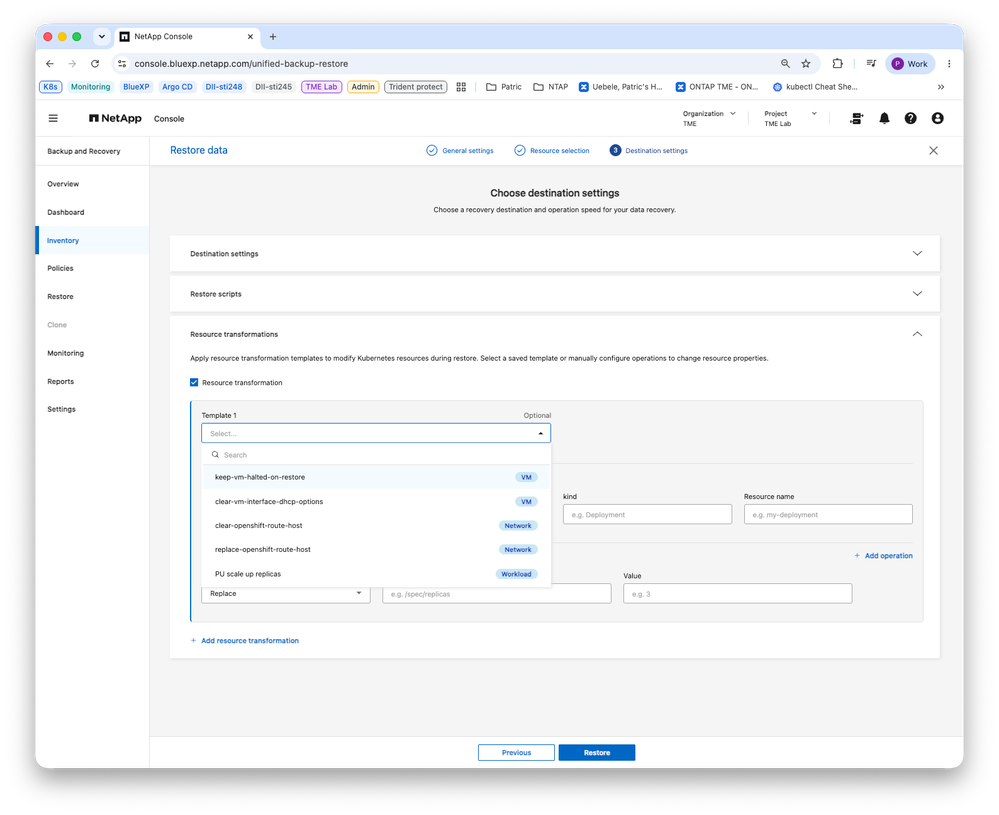

We select to restore all resources and expand the Resource transformations section in the final screen. In the Template 1 field, we see all available transformation templates, predefined and custom ones. We select the keep-vm-halted-on-restore template:
We then need to only fill in the Resource name app-vm-1 of the virtual machine and can start the restore operation.

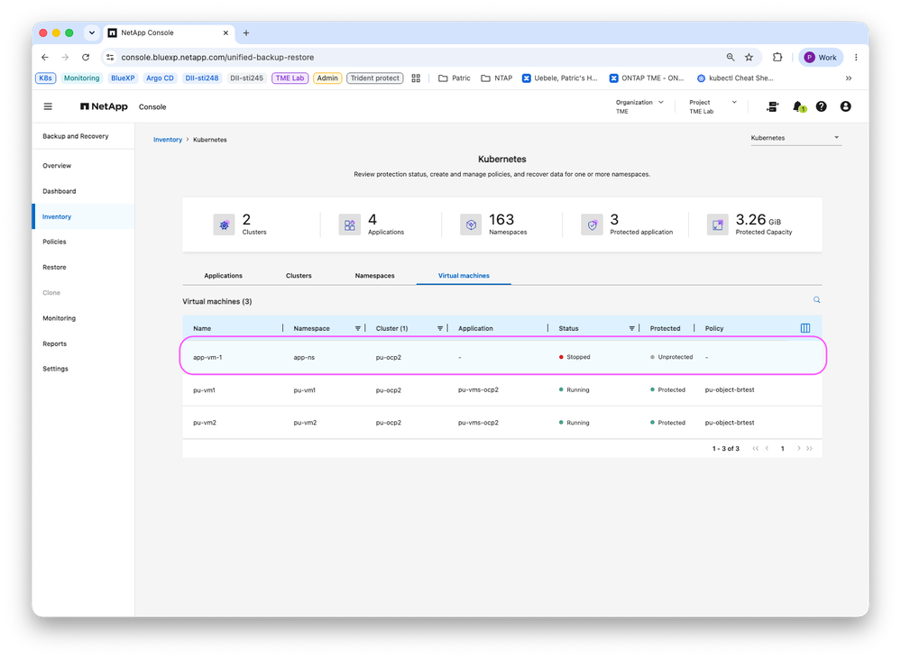

Once the restore finishes, we confirm that the VM is restored and in the Stopped state:
$ kubectl -n app-ns get vms
NAME       AGE    STATUS    READY
app-vm-1   135m   Stopped   False
