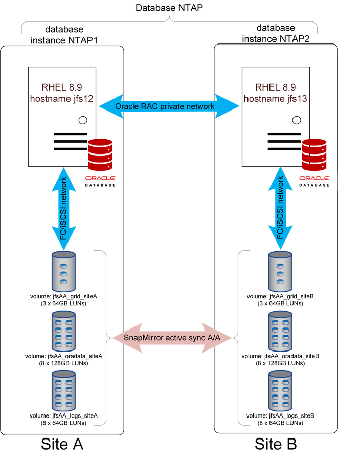

I'm developing reference architectures with and without a 3rd site Oracle RAC tiebreaker and plan to release some accompanying videos, but here's an overview of how it works. Take a look at the diagram and then continue reading to understand the value.
Architecture
This is a typical Oracle RAC configuration with a database called NTAP, with two instances, NTAP1 and NTAP2. The diagram might look complicated at first, but here's the key to understanding it:
SnapMirror active sync is invisible
From an Oracle and host point of view, this is just one set of LUNs on a single cluster. The replication is invisible. It's the same set of LUNs at both sites. I haven't even stretched the SAN across sites, although I could have done that if I wanted to. I'd rather not create a cross-site ISL if I don't have to.
When I installed RAC, I had a couple of hosts that each had a set of 3 LUNs to be used for quorum management. These hosts, jfs12 and jfs13, each see the same LUNs with the same serial numbers and the same data.
When I created the database, I created an 8-LUN ASM diskgroup for the datafiles and an 8-LUN ASM diskgroup for logs. It doesn't matter which host I use to make the database. They're both using the same LUNs.
Think of it as one single system with paths that happen to exist on two different sites. Any path either cluster leads to the same LUN.
SnapMirror active sync is symmetric
Database connections can now be made to either instance. If that instance needs to perform a read, the data will be retrieved from the local drives. Writes will be replicated to the opposite site before being acknowledged, of course, so site-to-site latency needs to be as low as possible.
It doesn't matter which site you're using. Database performance is the same, unless you intentionally used different controller models with differing performance limits. This is a valid choice. Maybe you want RPO=0/RTO=0 but one of your sites is designed to be just a temporary site, and doesn't require the same storage horsepower as the other site.
