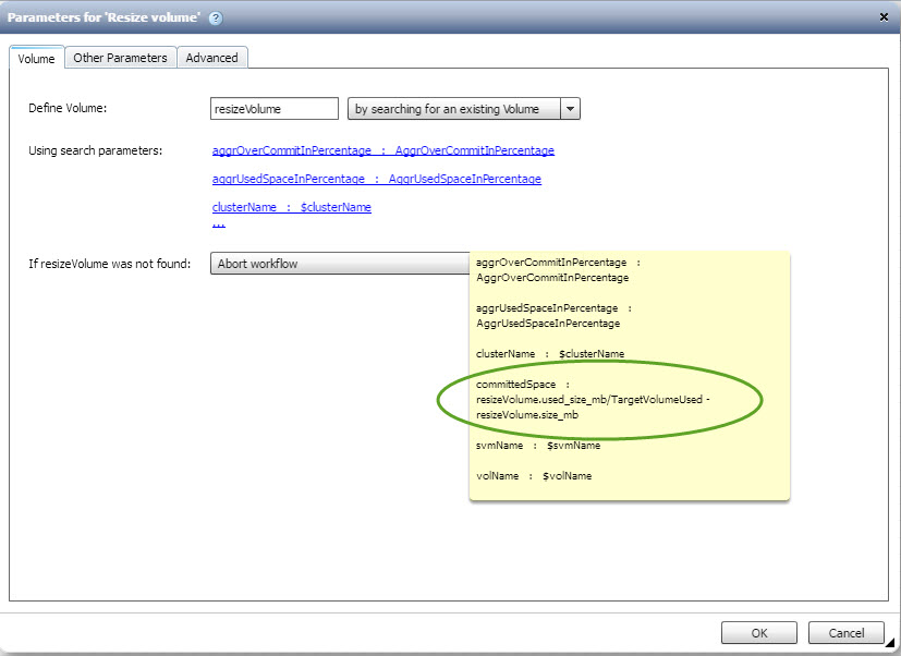

AdaikkappanArumugam
5,700 Views

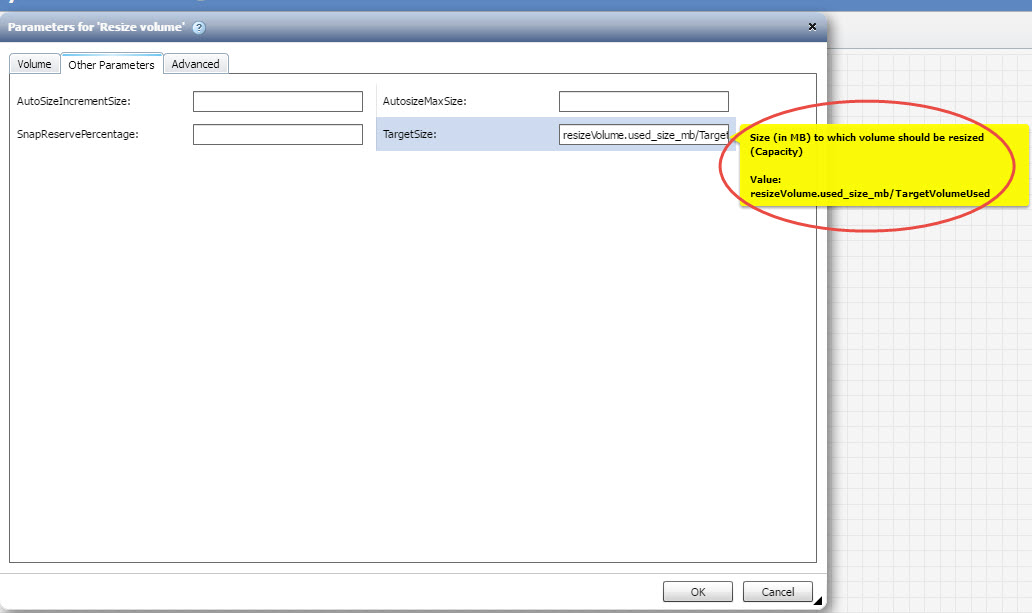

Is it becasue I reference the variable resizeVolume in the same command where the variable is being instanciated ?
Some times it works and some times it doesnt ?
For example when I have this expression  "resizeVolume.size_mb + 100" in the resource selection filter it doesnt work, where as the same in the other parameters tab of the command works.
Here is the screen shot of the same.

AdaikkappanArumugam
5,675 Views
Thanks Shailaja, I baked the MVEL expression equivalent  into the filter itself by getting it from the Volume table in the WFA cache db and it works like a charm.
