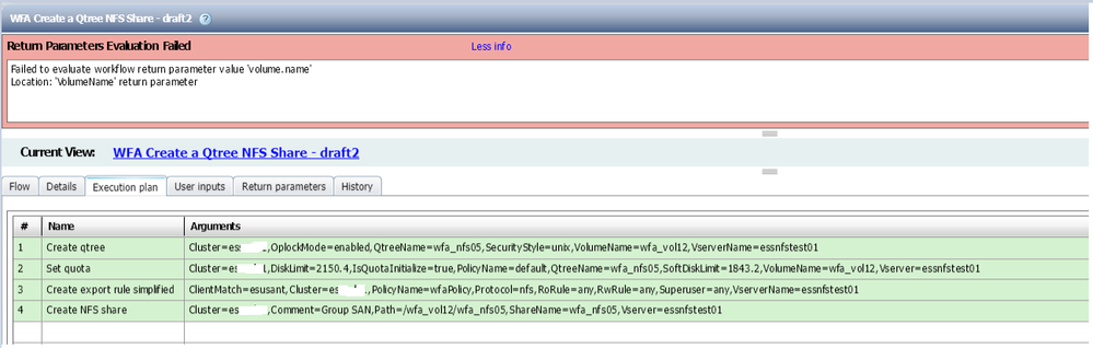

Hi, I'm tying to create a workflow for creating an NFS qtree/quota for an existing volume.
I seem to be stuck on this error message during a preview,
"Failed to evaluate workflow return parameter value 'volume.name'
Location: 'VolumeName' return parameter"
Though the execution plan seems to be evaluating the value for volume name per following screenshot.
What am I missing?
I'm using WFA 4.2 with OCUM v7.3.0.1 and OnCommand 9.3 P4.
I 'm not able to attach the dar file on this post as I'm getting this message " The contents of the attachment doesn't match its file type."
Thank you
Oliver

     Can you remove the return parameter from the workflow and try again.  You are inputing the VolumeName and it looks like the workflow is trying to return a Volume.name.  Not sure why you would need the return.

That worked!
Thanks for the quick response.
