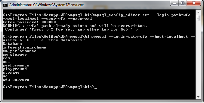

  2. Set a login-path for your WFA Mysql DB so that you don’t need to send clear-text password on the CLI when executing my SQL queries. Below are the steps to get this done
    1. Create a new mysql login-path for wfa
      1. Open a cmd prompt as “Administrator” on WFA and do the following.
      2. C:\Program Files\NetApp\WFA\mysql\bin>mysql_config_editor set --login-path=wfa --host=localhost --user=wfa --password
                    Enter password:
  1. Enter ‘Wfa123’ as password.
  2. Test that this worked fine by executing a query on the CLI as below.
 C:\Program Files\NetApp\WFA\mysql\bin>mysql --login-path=wfa --user=wfa -e "show databases"

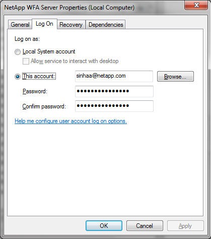

  1. Change properties of NetApp WFA Server service to start it as any Administrator account and not LocalSystem (Default). Restart service to take effect.

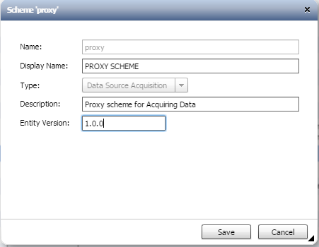

Go to WFA->Designer-> Data Source Designer -> Schemes, Create a scheme named proxy of Type Data Source Acquisition. You can choose any other name too if you don't like proxy. This is just a proxy scheme, no data ever gets filled here. No need to create any dictionary on it.

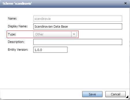

  1. Go to WFA->Designer-> Data Source Designer -> Schemes , Create a new scheme of type Other. In my example I chose name ‘scandinavia’ of type: Other . This is NOT the default type, so ensure you select it correctly from the drop-down. This is going to be my scheme or database to keep my data

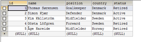

After acquisition, WFA scheme scandinavia , table football_players has all the correct names.
