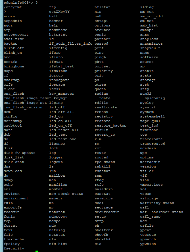

Well, I can't find the admin vserver. The "vserver show" command seems to not exist. So I'm stuck there actually. This 8.x is extermely differnt from 9.x and most of the documentation online for 8.x commands don't really work which is odd.
Ontapforrum
17,115 Views
vserver show should be there.
https://library.netapp.com/ecmdocs/ECMP1511539/html/vserver/show.html
Is it possible for you to show us the screenshot.
admin vserver is simply your 'cluster_name'.   We call it vserver 'type' as 'Admin'.

here is the screenshot.

I have 2 things going on here.
1. I need to configure LDAP for 8.2 ONTAP.
2. I need to configure LDAP for 9.3 ONTAP.
The commands for security login create I'm sure will work for 9.3, but they don't seem to be working for 8.2.
General
17,249 Views
Keep in mind when I log into the CLI for 8.2 I use "root". Never have I been able to login as "admin". Could that be the reason I don't see th correct commands?
How do I see and/or change the "admin" password if so, beacuse I have no clue what it is, that was before my time when this cluster was setup.
Ontapforrum
17,247 Views
Omg...that's 7-mode...lol. last version of the 7- mode ontap.
