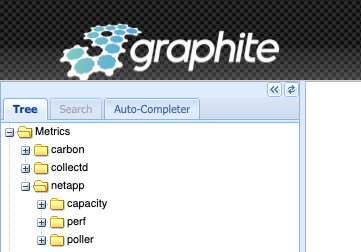

yannb
9,050 Views
What do you see here ?
ChaitanUni
9,015 Views
I don't see NetApp there ;(
