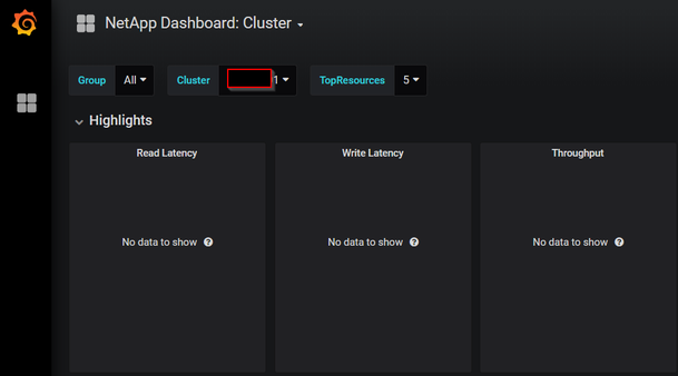

gpallis
21,177 Views
Oh, one other question that is not strictly related to Harvest, but it's more about Grafana. Any idea why for certain dashboards when I select anything different to All, I see no data? For example see below screenshot:
But when all clusters are selected then no problems at all:
2019-05-01 17_50_22-Grafana - NetApp Dashboard_ Cluster.png.
Thanks,
G
gpallis
20,588 Views
I think I figured it out. At least two resources need to be selected. Meh...
yannb
20,572 Views
That shouldn’t be the case, you should be able to select a single cluster in this dashboard

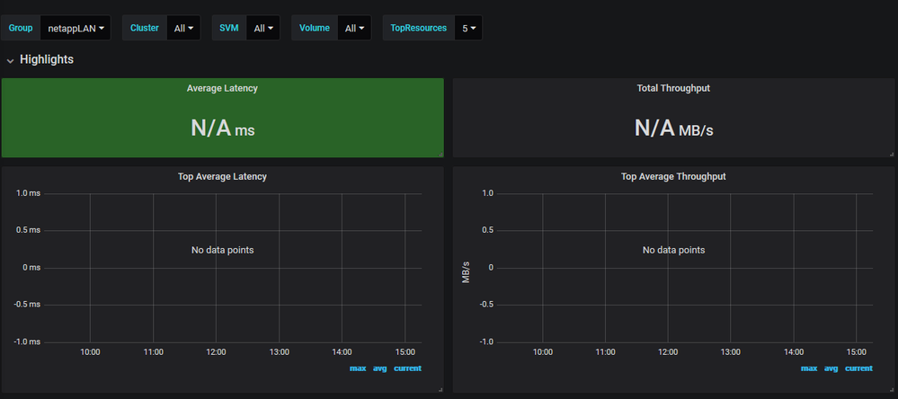

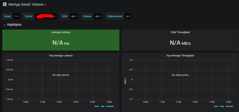

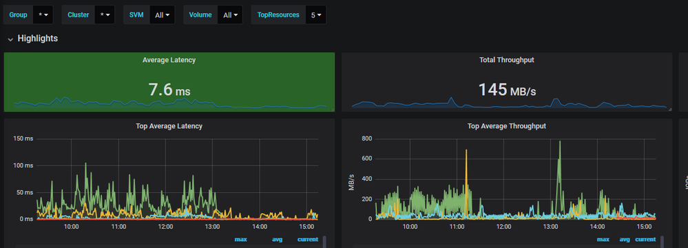

JohnathanIT
19,568 Views
Hi,
I'm experiencing exactly the same phenomenon.
Working with netapp-harvest+carbon+graphite+grafana as recommended in Netapp's manual.
When selecting ALL (or *), it shows all the data
When selecting a specific  group\cluster\svm\vol, no data is showed.
Images below:
All selectedAll selectedGroup selectedGroup selectedCluster selectedCluster selected
gpallis
19,000 Views
At least it's not only me. Unfortunately, I wasn't able to follow up with this due to other things happening.
JohnathanIT
18,994 Views
One more "funny" thing i found is that if you select 2 or more objects (vols, SVMs) it also shows data
But when selecting 1 object, there is nothing 🙂
