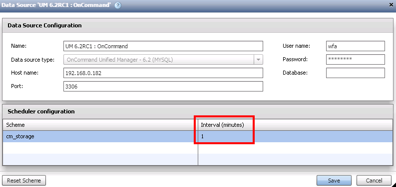

You can increase the frequency that the polling takes place by editing the data source in WFA, then changing the interval value.
Note that doing this will not increase the frequency that OCUM polls the storage systems.  You can increase this setting, but be aware that it may cause additional load on your OCUM server and on your storage systems if you poll too frequently.

Yep! I'm fully aware of the data source polling, and how it affects the overall accuracy of what WFA sees. We have this set at 5 minutes, which is a decent compromise between accuracy and (over)loading our OCUM instance. In unrelated news, we most likely have some kind of data issue between OCUM and WFA, as even after 1.5hrs our WFA instance still sees that deleted export policy.. that's another issue heh.
