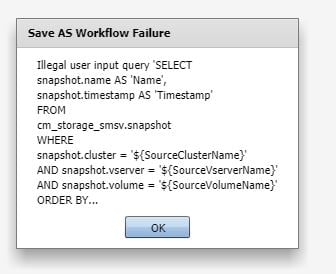

I've a problem with a workflow after I've updated WFA version from 4.1 to 5.0.1.  An user input query which select a snapshot drops an error when I wanted to modify/save the workflow:

Hi Zoli
Okay the WFA snapshot pack installed on WFA5 and your query works successfully as root. What's the output of:
SHOW GRANTS FOR 'restricted'@'localhost';
Is it possible the "restricted" database user does not have appropriate permissions the "cm_storage_smsv" database???
If the result is that the user does not have to permission connect to MySQL as root and  grant permissions:
GRANT ALL PRIVILEGES ON cm_storage_smsv.* TO 'restricted'@'localhost';
Note: The above command will grant full control to the database, that might not be appropriate for your environment.
Assuming you limit access to the "restricted" user (IE SELECT read-only) then...
GRANT SELECT ON cm_storage_smsv.* TO 'restricted'@'localhost';
Does that fix the problem?

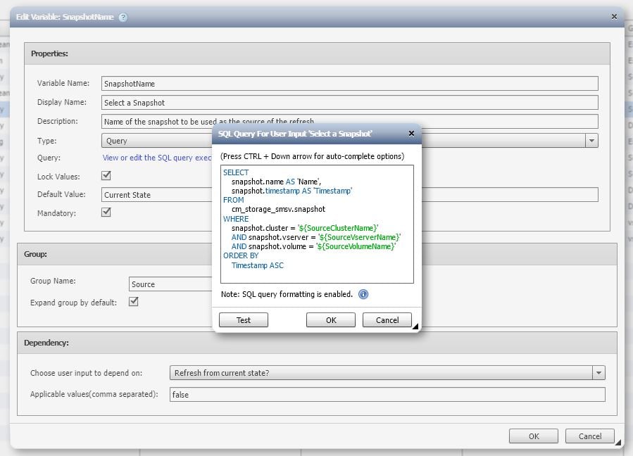

Hi Matt,
Thanks for suggesting HeidiSQL, I've just wanted to get some sql tool to test. With this I was able to  run the query, (only with root user, wfa read olny user drops access denied)
So I am able to ask snap from db with this tool with sql root user:
But Wfa drops error when try to test it:
I've checked sql user table and this is what i have:
Is this looks ok?  wfa user does not have any right.
I also cheked on a fresh clean install of wfa 5.0.1, and the user table is same ase here.
What do you think?
Thanks
Zoli

@mbeattie  sql command solved the permission problem for snapshots. Thanks!
@moep  thank you for suggestion, imported DAR!
