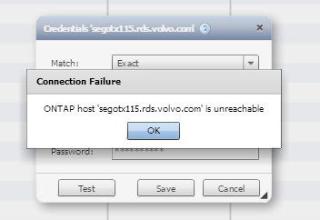

10,748 Views
Hi Guys,
I have a same problem and i have tried all steps given in this post but it does not work.
I get same error "Failed to connect to cluster node: 153.112.47.109.
Incorrect credentials for 153.112.47.109."
Plus when i test the connectivity i get error "Ontap Host is unreachable"
We have verified the Ports are open and Telnet works. Plus i can also run Powershell commands from this same WFA Server to C-DOT cluster.
I can add 7-Mode Netapps but not any C-DOT systems.
Kindly help
