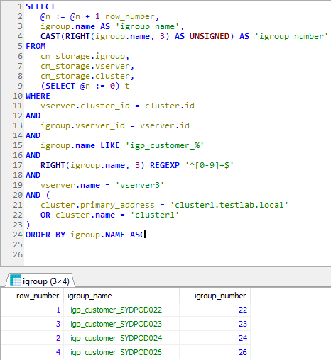

As an example i created a few igroups and developed SQL query to return the name and number. EG if i've understood your requirement correctly in this case you would want WFA to return number 25 (not increment the number to 27)?
I'm not aware of any native method to return the missing record in mysql (as a query only returns records that exist, not ones that dont). It's possible to create a temporary table, stored proceedure and compare records numbers but it's a lot of messing around and not something you could do natively in a query so i came up with another idea...

This will return the igroups (record index and igroup number) as a hashtable. EG
All that i need to add is the logic to return the first non-concurrent number in the sequence. EG in PowerShell the programming logic would be:

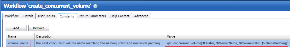

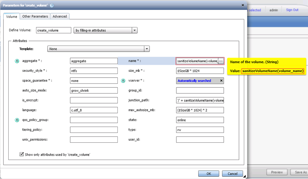

To answer your second question, if you wanted to use an MVEL function that invokes a SQL query and returns a result, you don't need to create a WFA command. You just call the MVEL function from within the command and if you need to reference the value more than once than consider creating a constant and set the constant value to call the MVEL function.
Then in your command when you set the volume name and junction path just reference the constant. EG
Note: It's advisable to wrap the volume name around the "sanitizeVolumeName" function to ensure the volume name only contains valid characters.

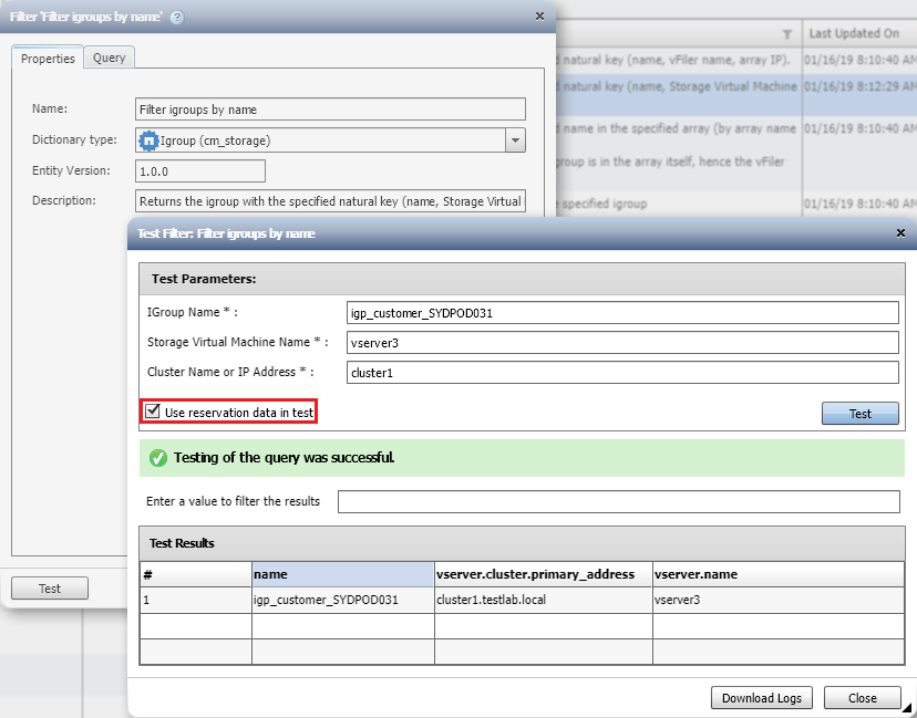

So, to answer the original question, here is the SQL you asked for.  Well not exactly.  You asked for a filter that will return the next available volume name.  That is not how incremental naming works.  The filter needs to return the name preceding the next available name, and incremental naming will generate the next available name from it.  This query should work:
