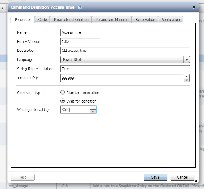

Something like Below:
A Wait for Condition type of command is a special command, it Re-executes the command code after the Waiting Interval ( see above in image ) period. It stops execution cycles if the cmdlet Set-WfaCommndProgress gets 100 for the Parameter -ProgressPercentage
WFA has some commands of type Wait for Conditions like Wait for Aggregate online. You can see them for help.

Then you need to trick your WFA command. Let's see how.
1. Have your command of type "Wait for Condition"
This allows you a timeout maxmimum of 277+ hours. Put any Time-Out value as you wish. Put waiting Interval(s) as 10800
2. Have anything in your command code as you want. Just at the end add this line.
Set-WfaCommandProgress -Total 1 -Current 1 -ProgressPercentage 100
That's all.
The logic :
I'm using the fact that a "Wait For condition" is command same as the standard command except that it repeats its execution after a give "Waiting Interval(s)" till the cmdlet Set-WfaCommandProgress doesn't send it to stop with ProgressPercentage as 100 or the Command Time-out is reached.
So I'm doing all I want, and in the end I signal that this command should Finish execution and not re-execute.
This allows any my comamnd to have time-out far much larger than 3 hours allowed for a standard command.
