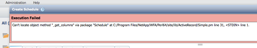

====== Here is the common error that I get on each workflow ======

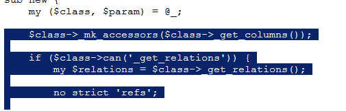

 ==== I've gone into .../Simple.pm andsee this statement, using the _get_columns method ====

C:\Program Files\NetApp\WFA\Perl64\bin>cd ..
C:\Program Files\NetApp\WFA\Perl64>cd site\lib
C:\Program Files\NetApp\WFA\Perl64\site\lib>dir
 Volume in drive C has no label.
 Volume Serial Number is 141D-6BDA
 Directory of C:\Program Files\NetApp\WFA\Perl64\site\lib
10/16/2014  11:24 AM    <DIR>          .
10/16/2014  11:24 AM    <DIR>          ..
10/16/2014  11:23 AM    <DIR>          ActiveRecord
10/16/2014  11:24 AM    <DIR>          auto
10/16/2014  11:24 AM    <DIR>          Bundle
10/16/2014  11:24 AM    <DIR>          DBD
04/09/2014  05:44 AM                31 sitecustomize.pl
               1 File(s)             31 bytes
               6 Dir(s)  20,684,660,736 bytes free
C:\Program Files\NetApp\WFA\Perl64\site\lib>dir ActiveRecord
 Directory of C:\Program Files\NetApp\WFA\Perl64\site\lib\ActiveRecord
10/16/2014  11:23 AM    <DIR>          .
10/16/2014  11:23 AM    <DIR>          ..
10/16/2014  11:23 AM    <DIR>          Simple
10/16/2014  11:23 AM            44,234 Simple.pm
               1 File(s)         44,234 bytes
               3 Dir(s)  20,684,660,736 bytes free
C:\Program Files\NetApp\WFA\Perl64\site\lib>ppm area sync
Syncing site PPM database with .packlists...done
Syncing perl PPM database with .packlists...done
parrizas
8,030 Views
Hi,
I was getting the same error until I installed the exact version of the ActiveRecord Module stated in the TR:
ppm remove ActiveRecord::Simple
ppm install http://ppm4.activestate.com/MSWin32-x64/5.16/1603.4/S/SH/SHOOTNIX/ActiveRecord-Simple-0.34.ppd
Cheers,
Alfonso
korns
8,021 Views
Bingo! Thanks Alfonso. That was my issue. I'm up and running now.
