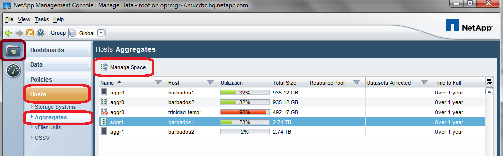

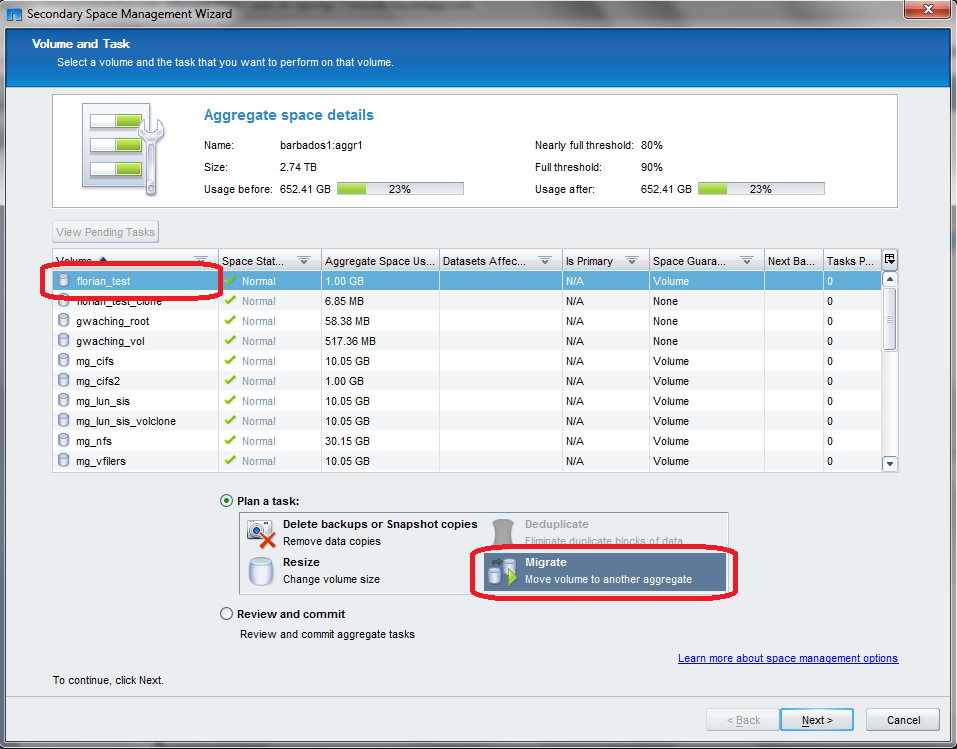

a) did you use the "magage space" wizard of the NetApp Managament Console (the Protection Manager GUI), or
b) did you move the volumes manually by using SnapMirror?
if a) everything should be OK as Protection manager itself takes care of migrating all the relationships alongside the volumes(s).
The Manage Space wizard:
