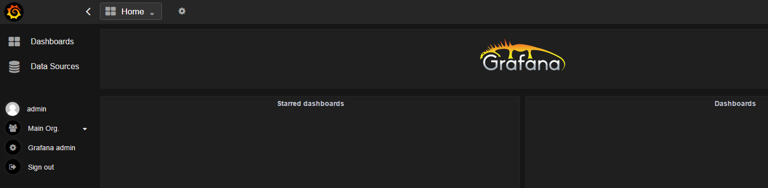

Hi Chris,
Here is the screenshoot of Grafana.
For port:
root@ubuntu14:/opt/netapp-harvest# cat netapp-harvest.conf |grep http
grafana_url = http://localhost:443
root@ubuntu14:/opt/netapp-harvest# cat /etc/grafana/grafana.ini |grep port
# The http port to use
#http_port = 3000
http_port = 443

madden
7,855 Views
Hi Eric,
You have some mixup I think.  If you want Grafana to run on HTTPS you need to also set:
[server]
# Protocol (http or https)
protocol = https
And then also configure SSL cert info:
# https certs & key file
cert_file =
cert_key =
So in the netapp-harvest.conf you have grafana on http on 443, yet in grafana he is listening on https on 443.  Also from your screenshot you have no dashboards loaded!
So you need to reconcile to use http or https consistently in grafana config and netapp-harvest.conf
I hope that makes sense!
