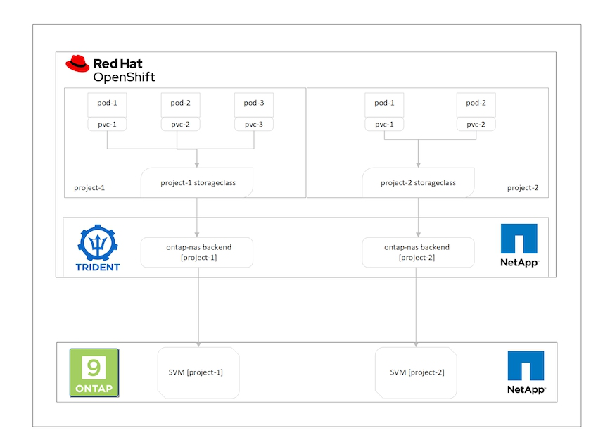

Referencing the below diagram and the URL here Architecture which depicts ONTAP w/ Trident w/ OpenShift (understanding there are differences to standard K8s).
Q2: How does the system ensure that Tenant B cannot access pvc1 or its underlying PersistentVolume (PV)?
A2: SVM isolation between tenants
Q3: What security mechanisms are in place (e.g., namespace isolation, RBAC, storage-level encryption, etc.) to enforce tenant isolation and prevent unauthorized access?
A3: SVM isolation and K8s Kubernetes Storage Resource Quotas.  You could have SVMs on different aggregates with aggregate encryption keys.    Per volume encryption via NVE is supported with Trident.

Hi Chamfer
In our environment, we have a Kubernetes (K8s) cluster that is used by different application teams. Each application team has a Namespace administrator. On the NetApp side, we cannot create multiple SVMs for each application team.
Hence, the above approach will not be applicable to us.
