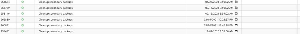

Hi i have snapcenter 4.3
i found in Programm out under monitor that cleanup secondary backup Jobs are still running/are not finished.
Maybie this is only Display error???
i also make a
under Task Scheduler Task is not running. is allready finish.

Hello,
In big environments the NSM DB of SnapCenter can grow to enormous size, this can cause the dashboard to load partial data or have delays in showing data. Please check the Kb below, you will need to contact support:
https://kb.netapp.com/Advice_and_Troubleshooting/Data_Protection_and_Security/SnapCenter/How_to_reduce_NSM_Database_size_in_SnapCenter
Thanks
