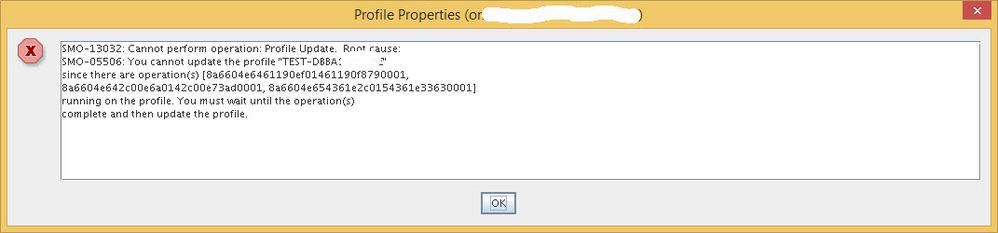

We are migrating from 7mode to cDOT and are updating our SMO to the latest version 3.4P3. We had 3.3 and in the manual I read that the repository need to be updated. However I receive the beneath error on updating. That makes me wonder if a new repository 3.4 is actually available? On the other hand I don't get my profile/backup job ready for snapvault. I added my snapvault destination cluster to snapdrive (snapdrive config set ... and snapdrive config set -mgmtpath ....). From that point I was able to select the protection policy SnapManager_cDOT_Vault, but then it gives an error when applying

Creating a brand new profile gives: Incompatible Protection Policy. SnapManager_cDOT_Vault is not valid for 7Mode.Very bizar.
