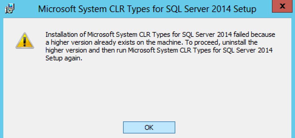

During the installation, the prerequisite component install for SQL 2014 CLR Types failed. I tried installing it manually by downloading it, but got the following error message:
So, I believe this to not cause an issue.

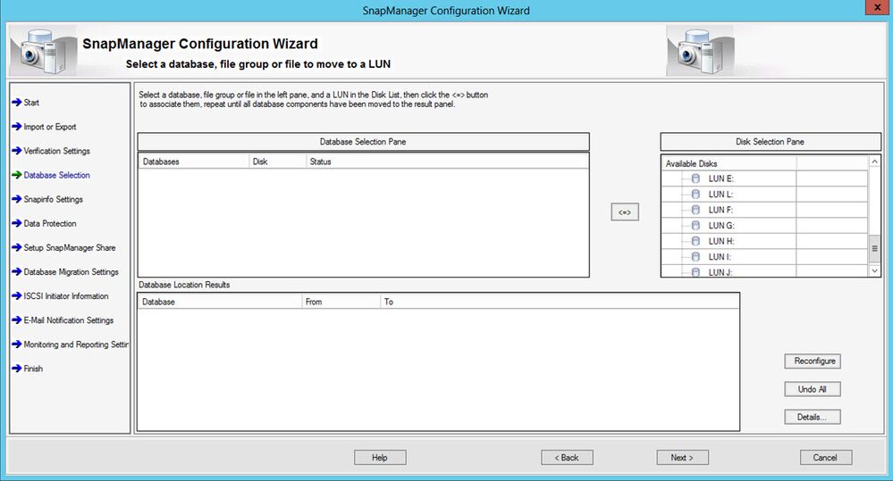

After installation, and while running the configuration wizard, I'm presented with the Database Selection step. However, there are no databases displayed:
My LUNS are displayed as per normal. When checking the Windows Event Viewer's Application log, I see this error:
"SQL-DMO did not return local installed SQL Server instances."

I'm unable to continue, and have found no reference to this error online.
I've checked the interoperatibility matrix, which suggested I use SMSQL 7.2.1, which I have also installed, but with the same issue.
Can anyone shed some light?

GRIMSTONER
11,314 Views
Hi
I've followed the steps in the KB, but am now presented with this error:
There are no errors in the event log to start debugging.

GRIMSTONER
11,305 Views
Hi
I've started the browser service as per the KB, but get the error as per the screenshot:
"Failed to load database information"
