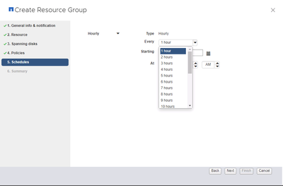

I'd like to create a customized schedule in the backup jobs but the only option I have is hourly, daily, weekly, monthly (frequency field).
What if I want to create a backup job every 4 hours for example ?

If you create a hourly policy, once you assign it to a resource group you can then select how often the schedule would run.  A dropdown menu will be available in the Resource Group pane for the schedule selection, in that dropdown it gives you an option as to how often the schedule will run.   From that dropdown, every 4 hours is an option.
