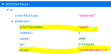

Unfortunately the example is wrong. You need to either change the 'name' parameter to 'channel' or use the controller's interfaceName or alias. Sorry for the confusion.
