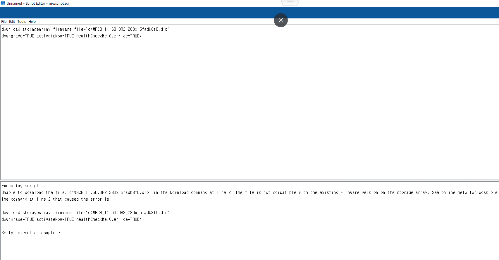

Whenever  running this command, I checked syntax first but there is no error. Also I restarted a santricity when error occurred if i have error because of wrong word.
I check  my hardware stratus, there is no error.
I already opened the case, but case  owner gave me a same command.
