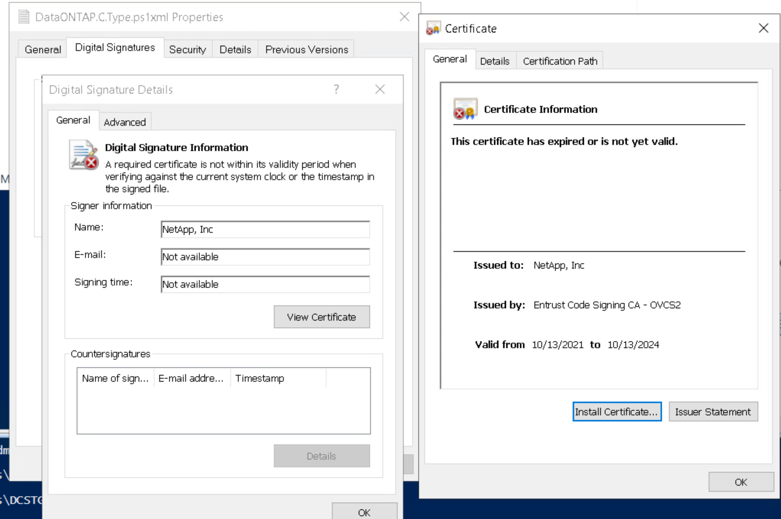

We are moving a Workday environment and it's dependent upon using the PSTK commandlets for all user provisioning, onboarding and offboarding. PS v. 5.1, PSTK 9.13.1.
We cannot install any version without hitting the same error.  It appears all the PSTK downloads are shipping with expired certs.  The certs expired 2 days ago on 10/13:
PS C:\Windows\system32> install-module Netapp.Ontap -force -scope AllUsers
PackageManagement\Install-Package : The module 'NetApp.ONTAP' cannot be installed or updated because the authenticode
signature of the file 'NetApp.ONTAP.psd1' is not valid.
At C:\Program Files (x86)\WindowsPowerShell\Modules\PowerShellGet\1.0.0.1\PSModule.psm1:1809 char:21
+ ... $null = PackageManagement\Install-Package @PSBoundParameters
+ CategoryInfo : InvalidOperation: (Microsoft.Power....InstallPackage:InstallPackage) [Install-Package],
Exception
+ FullyQualifiedErrorId : InvalidAuthenticodeSignature,ValidateAndGet-AuthenticodeSignature,Microsoft.PowerShell.P
ackageManagement.Cmdlets.InstallPackage
Failed to install or import required PSModules The following error occurred while loading the extended type data file: , C:\Program Files (x86)\WindowsPowerShell\Modules\NetApp.ONTAP\9.13.1.2306\DataONTAP.Type.ps1xml: The file was skipped because of the following validation exception: File C:\Program Files (x86)\WindowsPowerShell\Modules\NetApp.ONTAP\9.13.1.2306\DataONTAP.Type.ps1xml cannot be loaded. A required certificate is not within its validity period when verifying against the current system clock or the timestamp in the signed file..
, C:\Program Files (x86)\WindowsPowerShell\Modules\NetApp.ONTAP\9.13.1.2306\DataONTAP.C.Type.ps1xml: The file was skipped because of the following validation exception: File C:\Program Files (x86)\WindowsPowerShell\Modules\NetApp.ONTAP\9.13.1.2306\DataONTAP.C.Type.ps1xml cannot be loaded. A required certificate is not within its validity period when verifying against the current system clock or the timestamp in the signed file..

KevinMDavis
15,808 Views
Really, it appears that the developers here have missed the expiry on these certs, and need to issue new ones that need to be part of all the version downloads.  It's hard to imagine that we're the only environment enforcing code-signing.

Typically this breaks when you're working in an environment that enforces code signing (if you're not, you oughta be looking into that...).  PS tools are widely available, and to consider that malicious code could sneak into a public download is hardly outside the realm of possibility in this day and age.

What makes this problem worse is that the certificate that signed 9.14, and previous versions, is currently expired on the repository and did not include a timestamp server, so rolling back to any previous version is not possible unless you have your Execution Policy set to Unrestricted, which will ignore issue code-signing issues. The current guidance provided by NetApp regarding the expired code-signing certificate is to ignore code-signing with the Unrestricted policy, or download the code from NetApp support, however NetApp support only provides the latest 9.15 version containing the transient flag bug. Our company enforces code-signing, so setting the Execution Policy to Unrestricted is not an option.
Hey NetApp, next time you code-sign something, include a timestamp server, so the signature is not invalidated when your code signing certificate expires, since the timestamp server proves the signature was created when the certificate was valid, thus the signature stays valid even after the code-signing certificate expires.
I worked around this by downloading the nuget 'nupkg' file for the 9.14.1.2401 version from the manual tab on the repository page, which is just a renamed .zip file. I extraced everything to "C:\Program Files\WindowsPowerShell\Modules\NetApp.ONTAP\9.14.1.2401", minus the nuget specific folders: package, webhelp, webhelp.C, and _rels. I also did not extract the [Content_Types].xml file.
