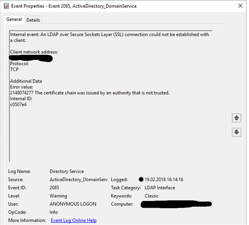

We have found our Problem:
On the DC we seen following Error:
On the DCs more than one certificate is installed. I installed the second certificate on the svm (security certificate install -type server-ca -vserver svm1).
After that i have reenabled the Option "use-start-tls-for-ad-ldap" and voila it worked again.
regards
Thomas

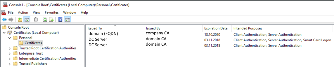

We have following Situation:
In the personal certification store on the DC server we have certificates issued by the company CA, which we have installed also in the svm (security certificate install). With this combination we encountered "Additional info: error:14090086:lib(20):func(144):reason(134)" Errors. Subsequently we installed also the certificate issued by Domain CA in the svm.
security certificate show -vserver svm1
Vserver    Serial Number   Common Name                            Type
svm1 06FFCFFAC88CB9B34454E628858B0FC2 company CA      server-ca
    Certificate Authority: company CA
          Expiration Date:
svm1 5F4CC1BFA244B7BF4301062863ABF4A2 domain CA             server-ca
    Certificate Authority: domain CA
          Expiration Date:
After that LDAP over TLS works without problems.
I hope this helps
