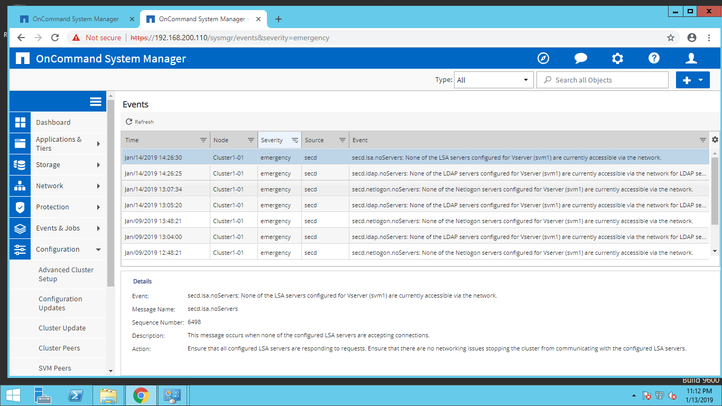

Hi all,
Need on advise on my configuration on netapp cluster which is i try to setup 1 netapp simulator cmode version 9.x using vmware workstation pro 15.0. I already succeed configure cluster (1 node), create aggregate and create svm with cifs protocol. I also have done to connect my cluster to my lab domain.
I also succeed to create volume, create share and verify a juction path on svm. All in good condition. But when i try to mount the share file that i create, it failed. It show in event log in the netapp as per below.
I already try few resolution that i found in the KB when i google it but still the issue still persisted. Any idea on this issue?

Have you create the mount export policy for the CIFS mount
and cretade the rule in it on export policy including access rights.
Bhanoji7
4,873 Views
dis you map the root user to admin on the CIFS share. Also by the error messages it says not able to reach the logon servers (DNS servers). perform the ping test and try to set the prefdc for this SVM.
Best Regards,
Bhanoji.
wareer
1,948 Views
Check whether the DNS server is working properly. Ping the DNS server from the memory to verify the basic connection to the DNS server. If the basic connection to all configured DNS servers fails, check the network path between the memory and DNS server.
If the DNS server is permanently inaccessible, remove it from the DNS configuration of the SVM and replace it with an accessible DNS server.Here are some related kb links, you can try to solve:https://kb-cn.netapp.com/on-prem/ontap/da/NAS/NAS-KBs/Creating_CIFS_Vserver_fails_with_the_message_Error_Machine_account_creation_procedure_failed_due...  https://kb-cn.netapp.com/on-prem/ontap/da/NAS/NAS-KBs/EMS_secd_lsa_noServers_-_Resolution_Guide
