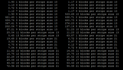

btw, what does these different stripe size mean in the statit output ?
is it reated to the RG size ?
