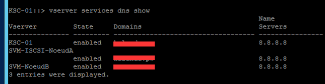

Nick_Elliott
19,686 Views
Sounds like the DNS settings are not configured or wrong for the cluster svm.
What is the output to an nslookup from a host to the mail server?
What is the output of vserver services dns show?
kal
19,668 Views
Thank you for your answer.
The 'nslookup' from the host to the mail server works fine.
My domain is in Wan, that's why the DNS server is the Google's DNS. (I hide the domain for the bots).
- "KSC-01" il the cluster.
- "SVM-ISCSI-NoeudA" is the SVM of the node 1
- "SVM-NoeudB" is the SVM of the node 2.
When I ping google from the 2 SVM, it works fine.
But the AutoSupoort is configured in the node, not in the SVM, isn't it ?

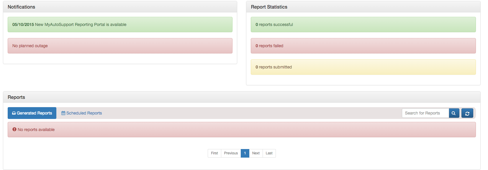

HTTP is "sent-successful". But in the Autosupport website, I have nothing :
What do you think ?
Regards.

You opended the thread on the reachablility of the mailserver, but on the output you have send i see that SMTP is ignored. Did you fill in any address to send the asup's too?
             Seq                                    Attempt  Percent  Last
Node         Num   Destination Status               Count    Complete Update
KSC-01-A     317
                   smtp        ignore               1        -        2/23/2016 14:06:23
                   http        sent-successful      1        100      2/23/2016 14:07:39
                   noteto      ignore               1        -        2/23/2016 14:06:2
As for the asups in your overview, it can take some time for them to show up.
 Regards,
emile

kal
15,011 Views
Hi Emile,
I have resolved the issue. I waited about 3-4h then I checked the myautosupport. The overview is here !
Thanks a lot for your help !
Best regards.
