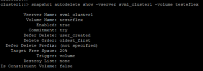

I checked at LOD. System Manager still do not show that option. But I was able to enable snapshot autodelete for the flexgroup volume using the CLI:
So I believe it is implemented, but not yet in the GUI.

Ontap Cluster with 5.11 code displays this error when trying from CLI:
::volume snapshot autodelete> modify -vserver svm-1 -volume ConversionTest -enabled true
Error: command failed: Modification of the following fields: snap-autodelete-enabled not allowed for volumes of the type "FlexGroup volume - Read-Write volume".
But based on your checking it must be working in 5.12.  Thank you so much this really helped me out!
