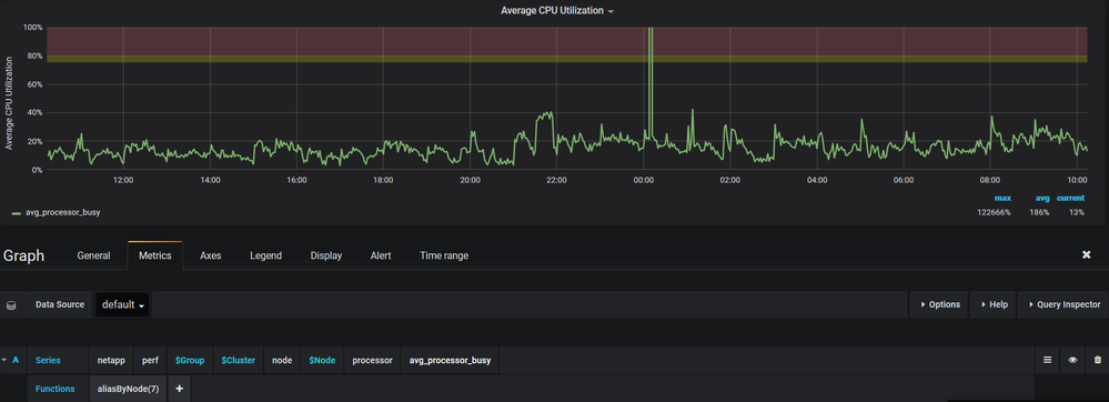

Some months ago we expand our 4 node Metrocluster with AFF700 to an 8 node Metrocluster. The Ontap version was 9.7P7 and since May 30th we have 9.7P13 running.
The Grafana is installed with this versions:
netapp-harvest-1.6-1.noarch
graphite2-1.3.10-1.el7_3.x86_64
grafana-5.2.4-1.x86_64

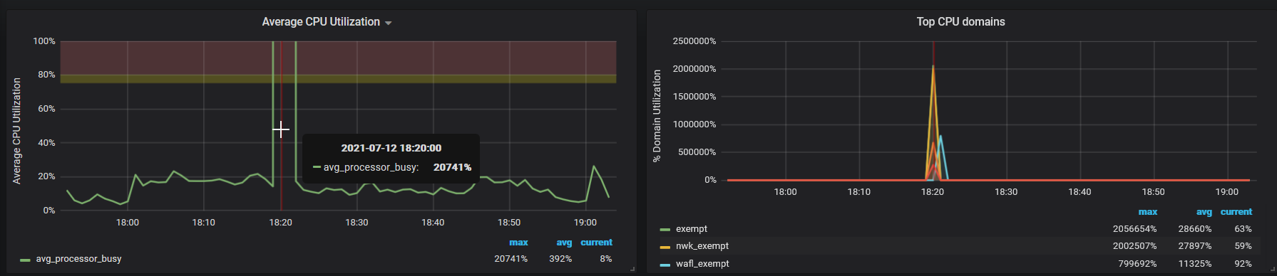

After this expansion one of the new nodes have very high (~20000%) CPU utilization for about 3-4 minutes. This peaks appear irregular. There are no other peaks from volumes or network during the same time, what could be the reason for this CPU peaks.
We opened a case and Netapp checked the Metrocluster, but everything is fine. They don't see in the perfomance data they have any CPU peaks or problems.
So we and Netapp think, the Grafana is not working fine or uses wrong performance data.
Here is a chart:
Does anyone here have similar problems or an idea what the reason could be.
We would be happy for any suggestions.

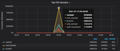

I checked the whisper file nwk_exempt.wsp from the effected node
Thu Jul 15 05:39:00 CEST 2021>>> 104.09428531740799428462196374312043
Thu Jul 15 05:40:00 CEST 2021 >>> 930840.22062434302642941474914550781
Thu Jul 15 05:41:00 CEST 2021 >>> 143.93252139853800031232822220772505
and you can see, this value is exactly the same that grafana is presenting.
I wonder, where this high value is comming from.

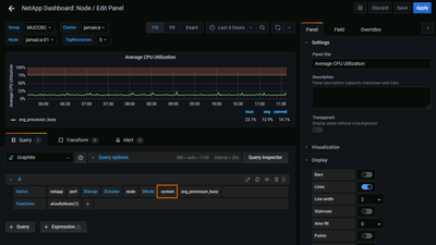

(1). In Grafana, can you open the graph editor and replace "processor" with "system" in the query as in the screenshot below? Harvest actually get's the same counter "avg_processor_busy"  twice from ZAPI. One is pre-calculated by ONTAP (system.avg_processor_busy) and one is calculated by Harvest itself (processor.avg_processor_busy). Can you check if you still see the high peaks?

1) We changed the graph to "system" and now we don't see any peaks.
It seem's that the calculation from Harvest is not working fine. Do you have a more detailed explanation for this?
