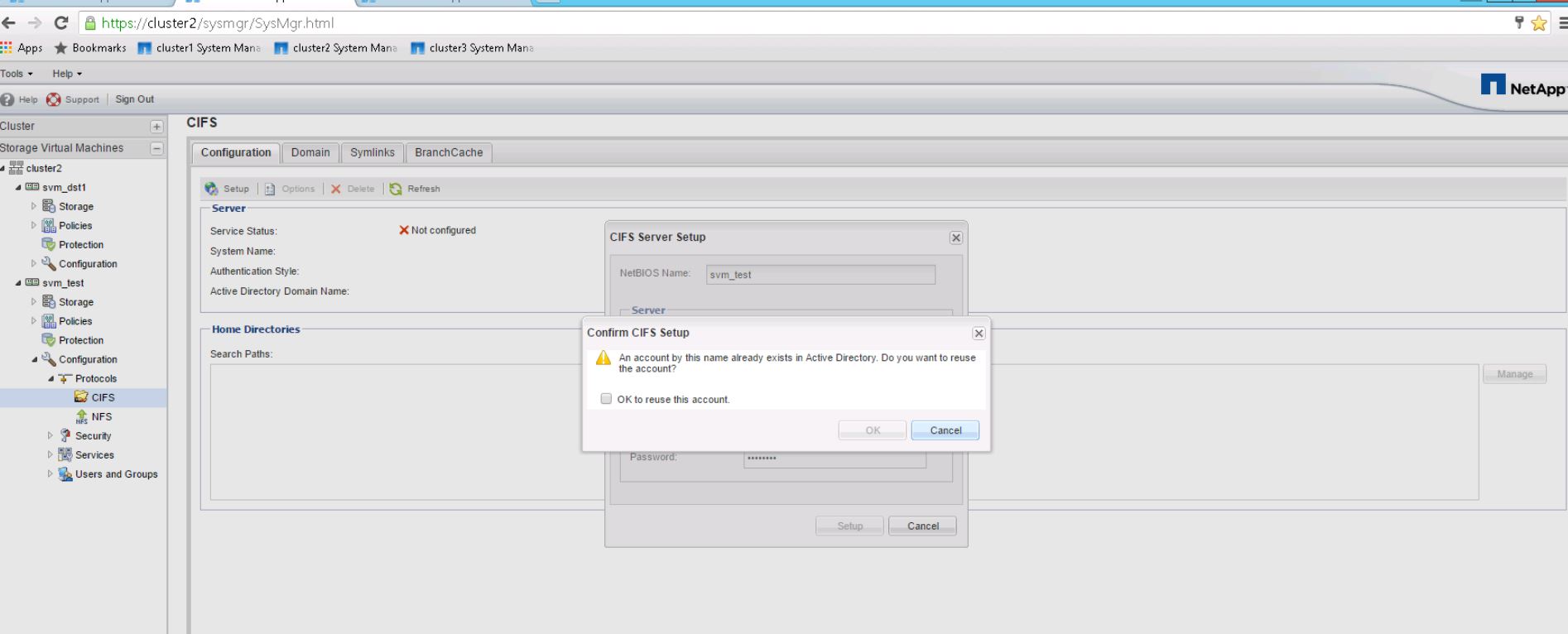

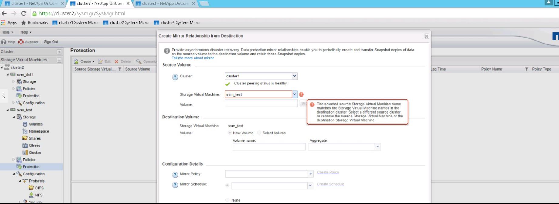

You cannot have same SVM name at Source and Destination as i have tried in my LAB and got the error below
Cluster1 is my Source Cluster and Cluster2 is my destination
I used the same SVM name " SVM_TEST"  and while create i got the warning in my destination stating there is already an entry in my DOMAIN but i still continued choosing ok to reuse the account and guess what my while i try to setup Snapmirror i got error that i must change the SVM name.... Refer to the screenshots... ( May be can give a try if you have different Name Server at Source and Destination )
