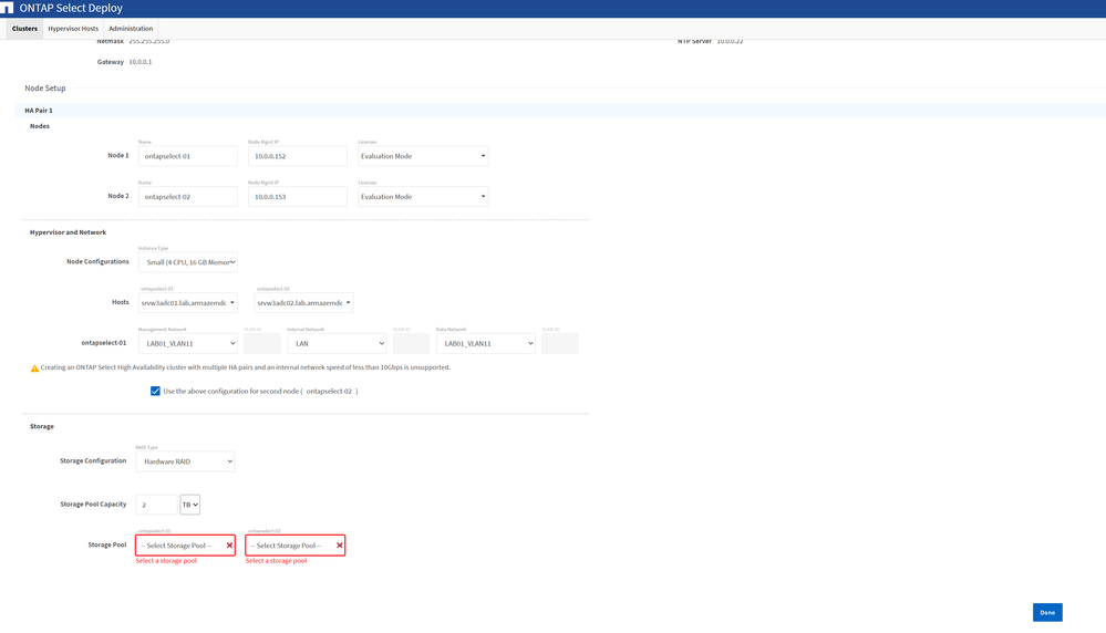

I’m facing an issue while deploying an ONTAP Select cluster (2-node HA) using ONTAP Select Deploy 9.18.1 in a VMware environment.
During the cluster creation, the Storage Pool dropdown is empty, even though I have available datastores that should meet the requirements.

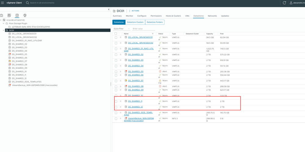

What I verified:
  • I created new shared datastores (DS_SHARED_11 and DS_SHARED_12)
  • Each datastore:
    • 2 TB capacity
    • 2 TB free space
  • Datastores are visible and accessible in vCenter
  • Both hosts are part of the same datacenter and see the same storage
  • Minimum capacity requirement is met (UI shows ~1.9 TB required)
Issue:
Even with these datastores available, the “Select Storage Pool” dropdown does not list any options.

  • I previously had smaller datastores (~1 TB free) that were not listed, which made sense due to requirements
  • After adding larger datastores (2 TB free), the issue persists

I’ve attached screenshots showing:
  1. The available datastores in vCenter
  2. The ONTAP Select Deploy UI where no storage pools appear
Question:
Is there any additional requirement or constraint (permissions, datastore type, host configuration, vCenter integration, etc.) that could prevent ONTAP Select Deploy from discovering these datastores?

I'm facing a very similar issue, main difference is, that I want to deploy a single host evaluation cluster. Also, I can't see any storage pools when selecting hardware raid. Software raid is also not possible (no qualified disks). Did you find a solution?
