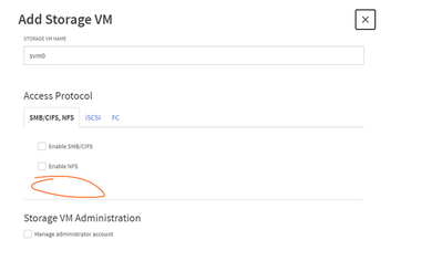

Hello!
We have A700 4-node FC metrocluster. ONTAP version is 9.12.1P14. I have successfully installed demo S3 license for testing purposes. But the problem is that i can not enable S3 protocol when creating new SVM. Also, there is no option "Bucket" in System manager.
I did not notice the same problem on other systems before.
Did i missed something here?
Can you help me with this issue?
Thank you!

Hello:
    I don't know if you forgot to add any parameters when you created the SVM, the following article may be helpful to you
https://docs.netapp.com/zh-cn/ontap/s3-config/create-svm-s3-task.html

Try the command line
 vserver s3 create
 command. Sometimes the GUI has a conniption and doesn’t do what it should
TMACMD
1,862 Views
I’ve had the issue with making lifs. The svm has the protocol but the GUI won’t make the lifs. The cli worked fine
