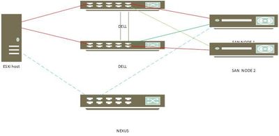

Hello,  bellow is quick sketch of what I have. It is not a sophisticated, it is simple. What I am doing is taking one path from DELL to Nexus (blue dotted lines). Everything is functioning properly but i can't ping from host to the adapter on the SAN that been moved.

If it starts working when you swap it back, it's unlikely to be anything on the NetApp. Swapping switches in the way you're planning would be a supported non-disruptive operation.
Check that jumbo frames are enabled if your network is using it, and that both the host and initiator ports are the same configuration in terms of native VLAN ID, trunking IDs, channel group, etc.
Once you've checked that, Run tcpdump or wireshark on the host and pktt on the netapp to see if any traffic is getting through.
Hope this helps!

I completed migration. There was a problem with switch configuration  (spanning tree and some features were not enabled). Migration was ND and pretty straight forward.  Thank you everyone for assistance.
