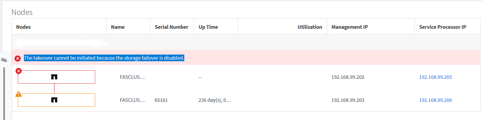

Apologies if I get the terminology all wrong. I've got two netapp filers configured as a cluster. It's ancient hardware, I migrated most of the servers hosted on there in Azure so we didn't bother renewing the support contract. One of the disks died a while ago but we had a spare which kicked in. And it ran without redundancy. As luck would have it, just before the migration project was finished another disk died and that bought down everything. I'm assuming the disk dying bought it down, and that no other hardware has failed. I would have thought the 2nd cluster would have taken over but it didn't.
The status on the node says;
The takeover cannot be initiated because the storage failover is disabled.
I'm guessing that because the disk died in the 1st node, that bought it down. So I thought if I replaced the disk then assigned it to the downed node it would come into life. However, I can only assign the unsigned disk to the node it can see. I can't get to node 1 at all
So, I think my only option is to try and force the failover mode to the 2nd node in the cluster.

to troubleshoot the down-node, you need to access the down-node using a console cable, or the service processor via SSH (according to your screenshot, the IP is 192.168.99.205, I also suggest setting the SSH session to record output and increase the console line buffer). the user should be any privileged local one you have (admin ?). once you in, you can type "system log" to try and see what was the issues leading to it, and perhaps the reason for the failover disabled, and you can type "system console" so you can access the live console and see the current error, or boot process issues are and continue the troubleshooting. if you see it in loader (very common, it will say LOADER > ) you can simply type boot_ontap.
