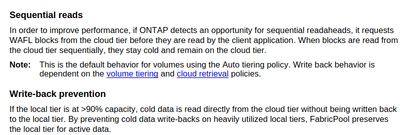

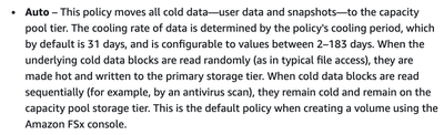

We are not able to put that data on a dedicated volume without tiering. But we do know the folders in scope of the application beforehand and would like to "pre-warm" them before it's accessed sometime after. Is there a way to achieve this? Even if its just a script? How can make sure that we dont do sequential reads because from what I read, sequential reads do not result in the data ending up in the performance tier. Is this correct?

The original data are read as you established in the question, so it should not be warmed, but there are some conditions and it depends on policies. See TR-4598, e.g.

Yeah i also have read that in the documentation that i found within AWS for the service we are using. I was not sure though if a folder copy is a sequential or non-sequential read and even if so, if changing the cloud-retrieval policy (https://kb.netapp.com/onprem/ontap/dm/FabricPool/How_to_move_the_data_from_capacity_tier_to_performance_tier_in_FabricPool) to "on-read" would maybe help then.
The best case solution for us would be if it would be possible to promote only a specific folder to the performance tier instead of a whole volume (with cloud-retrieval-policy -> promote). Therefore the idea to write a script or something that basically implementes such a feature via e.g. copying the data to some place to warm it up before the business applications wants to access it the day after.
I am not sure how likley a future change of the cooling period to more than the currently possible 183 days is.
