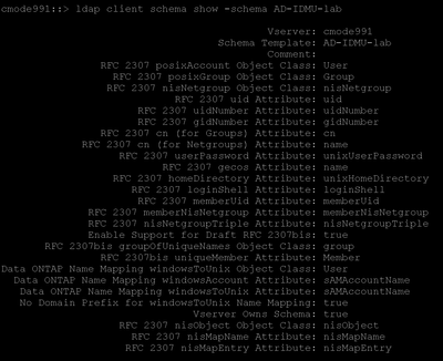

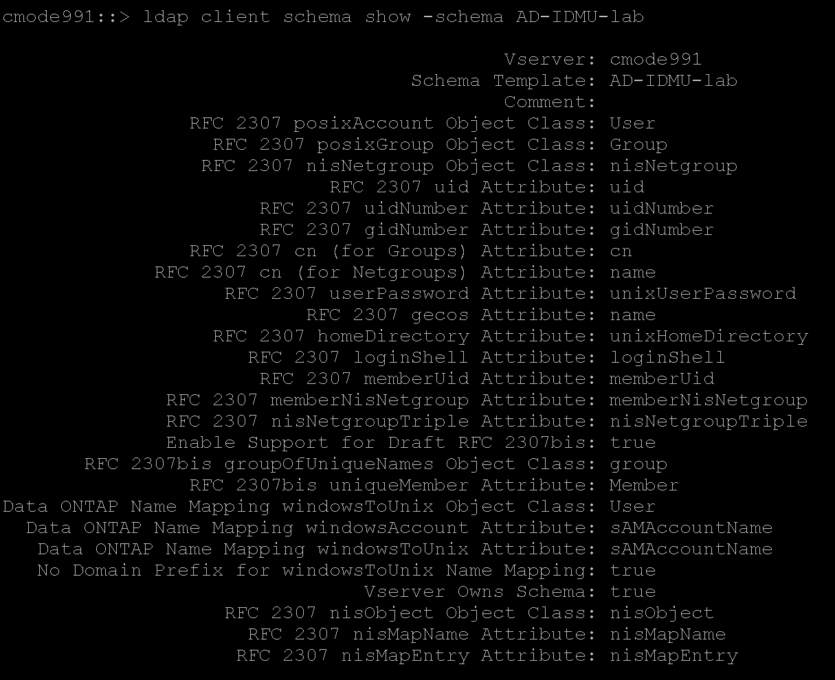

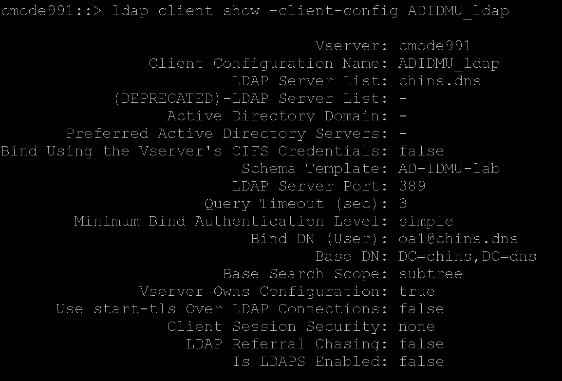

- schema copy AD-IDMU to AD-IDMU-lab and change groupOfUniqueNames, uniqueMember and Name Mapping windowsAccount

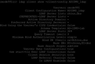

- setup ldap client as below

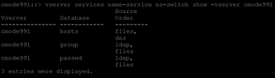

- modify name-services as below

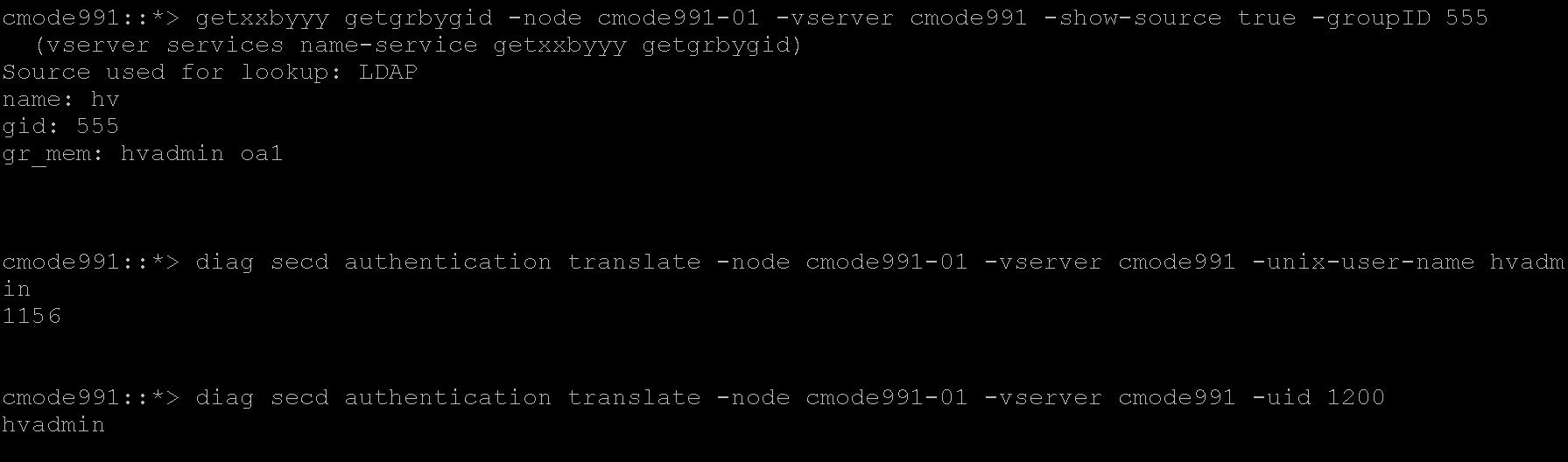

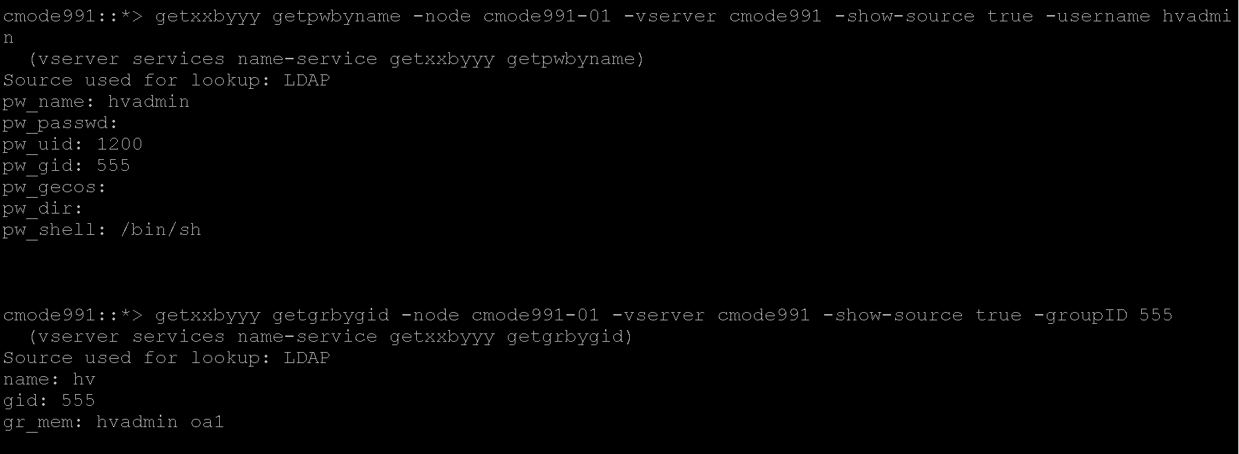

- test UNIX credentials are pulled correctly from Windows AD LDAP
- check the ldap status no problem

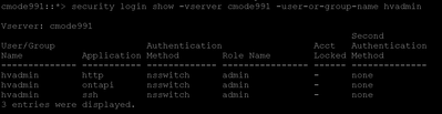

- security login account add in cluster

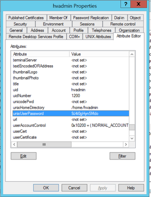

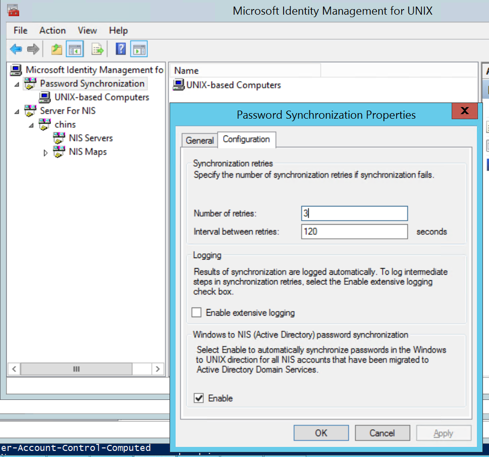

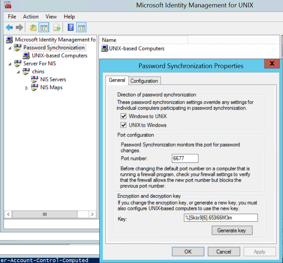

- Install Identity Management for UNIX, Server for NIS and Password Synchronization

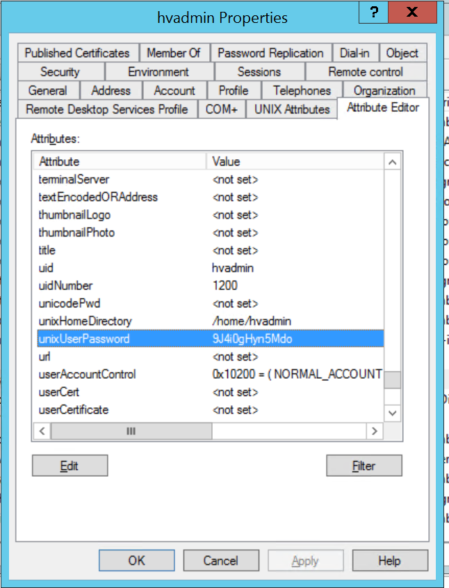

- reset hvadmin password trigger password synchronization, the unixUserPassword update

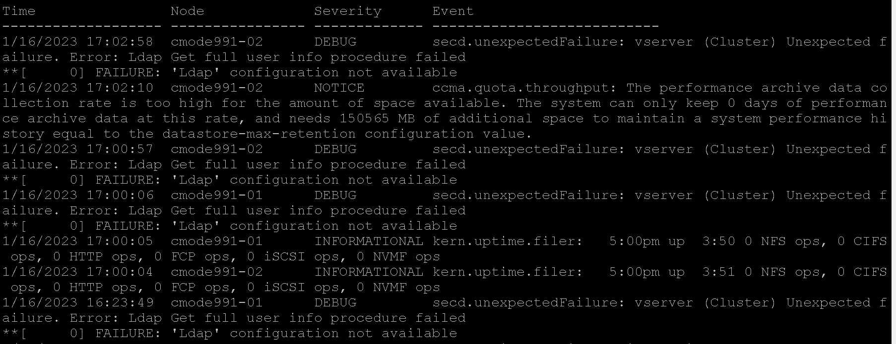

- try login ssh display "Access denied" or system manager and display "Sign In Failed. Please verify Username and Password."

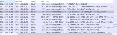

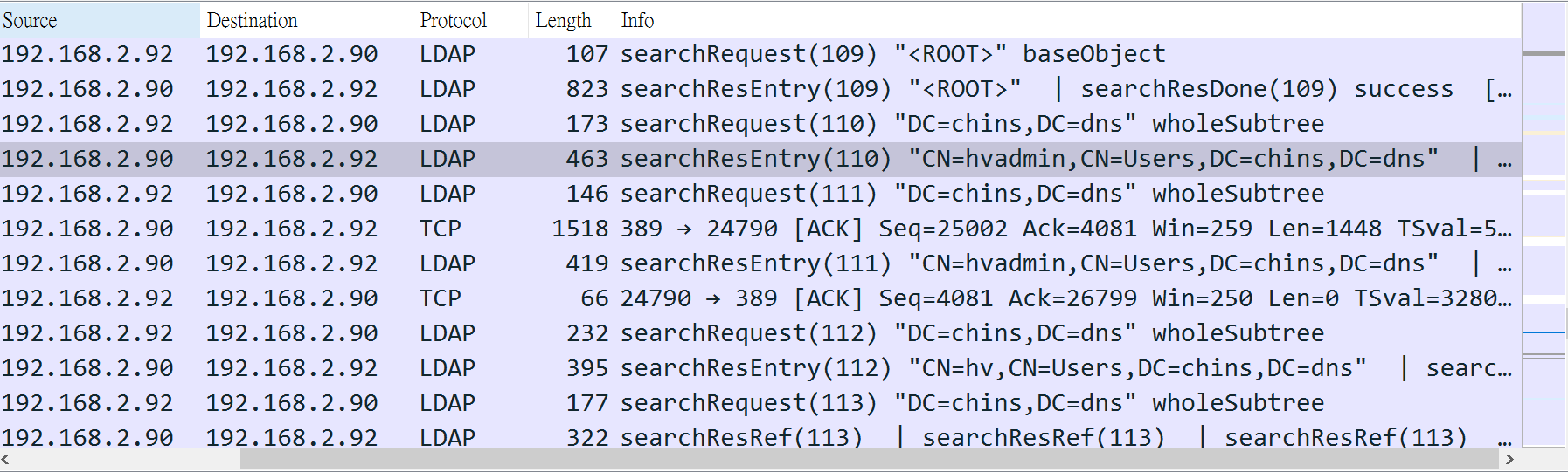

- when login with hvadmin, wireshark display it will query ldap but event log not much info troubleshoot

I found the problem, Windows AD Schema did not allow search unixUserPassword, change below problem fixed.
ADSI editior > select a well known naming context > Schema > OK > searchFlags Attribute for CN=unixUserPassword change default 128 to 0
right click Schema > Update Schema Now
