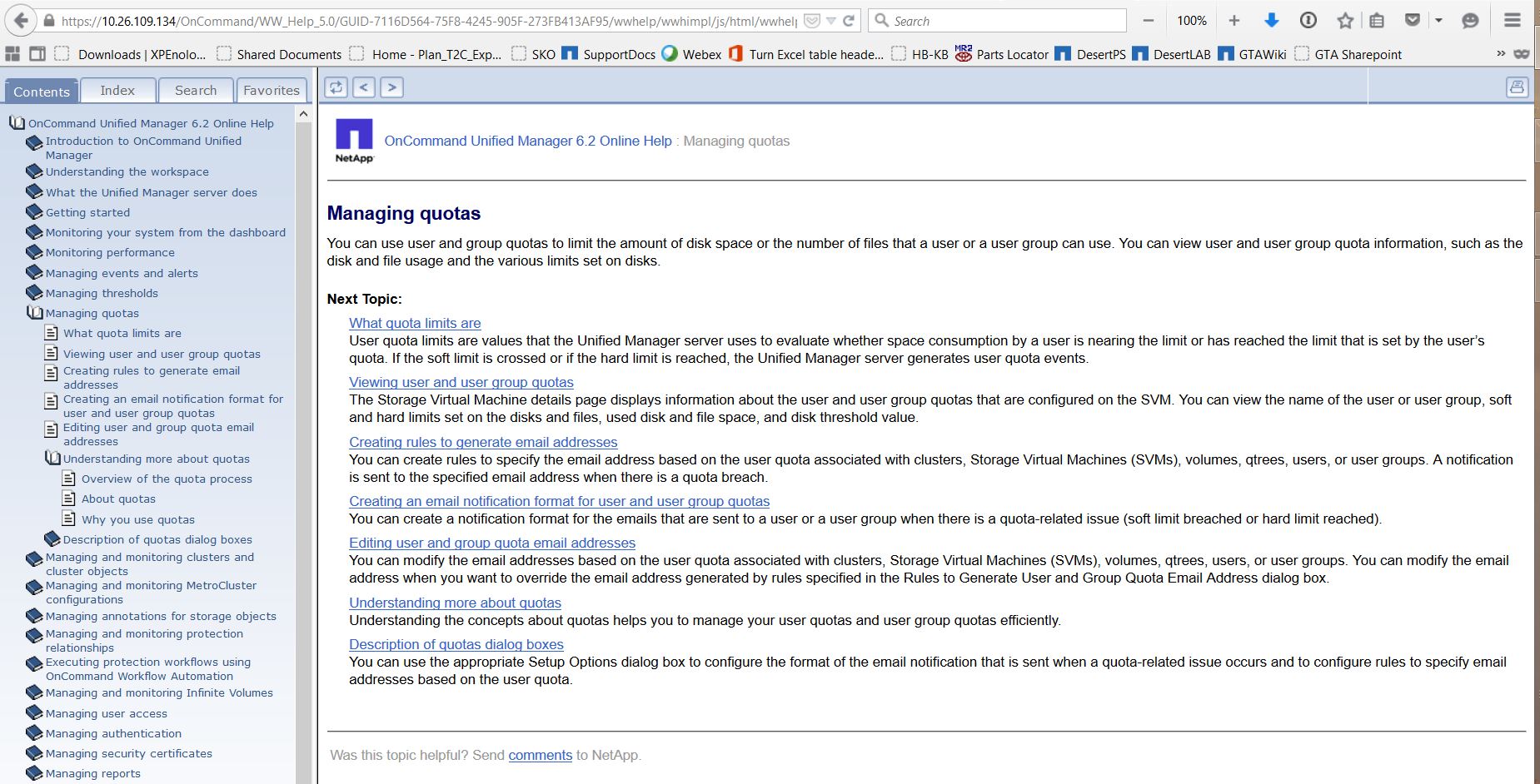

To perform the email notification on quota events, there is good integration with OnCommand Unified Manager 6.2 to support email notification, custom email messaging, and rule-based email alerting.  You can download OnCommand Unified Manager (OCUM) at this link.  There is an alternate link for RHEL based installs:  http://mysupport.netapp.com/NOW/cgi-bin/software/?product=OnCommand+Unified+Manager+for+Clustered+Data+ONTAP&platform=VMware+vSphere
See this screen shot of the online help which has the best explanation of how the quota email alerting works.
