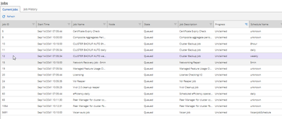

We have a list unclaim jobs as per the screen capture in Netapp Box as below Ontap 9.7
We tried the advanced mode
job unclaim -vserver PENSECD -id 15
however that did not work the job still show unclaimed and the future date is in the future 2041.
How do we resolve this one? Any idea?

It looks like the clock got messed up at some point. I'd say the job needs to be recreated or modified, but I'd get Support's involvement. What an odd issue.
