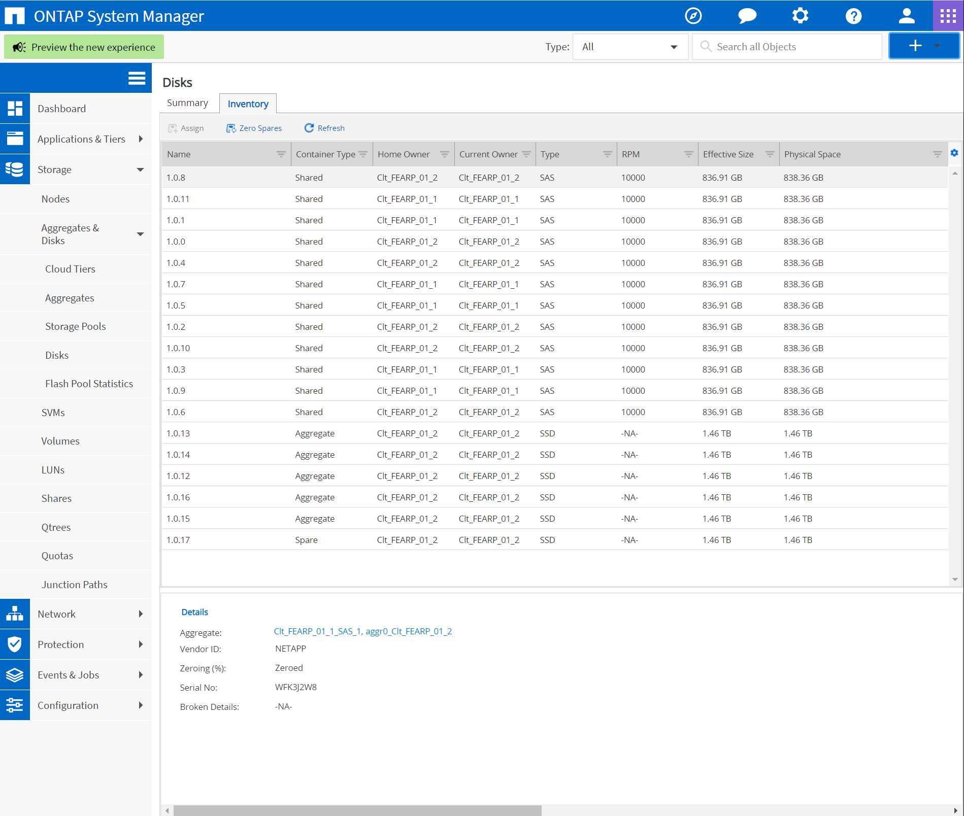

We just brought 6x new 1.6Tb SSD's and I'm trying to create a new aggregation, but without success. Actually, almost. I'm using ONTAP GUI interface to create this new aggregation. Durin wizard, it say that is not possible to automatically determine the correct aggregation because we have less disks than what is needed. Ok.
Them, I switch to manually create and proced on wizard. After all, I have onde aggregation with 5x disks + 1x spare. The problem is that all these disks are owned by only one controller node, not 'shared' like the other aggregation.
So my question is: is possible to create a new aggregation type 'shared' with only 6x disks? (We don't want to mix SSD's and non-SSD's since we already have non-SSD's in production).
You can see the difference here in this screenshot:

Aggr0 is running on the Root partitions, If you assign your 6 SSDs to Controller A and Build a 5+1 Aggregarte on the Home Node Controller  A, in a failover the Controller B will temporialy the Owner of that Aggregate.
To assign a Disk to both Nodes you need ADPv2, AFF oder FAS System with SSDs..
What ADPv2 does is to partition the Disk into 3 Partitions, one root, two data - each Data Partition will be assigned to another Node.
This can apply to controller B too? I mean, now I have these disks (SSD's) owned by controller B and one aggregate created. In case of failover, the controller A will owner this aggregate (temporarialy), like you said that controller A would do?
I don't really need to 'share' disks like I said, I just need to make sure that if onee controller goes down, the another one take controll of this new aggregation.
Fabian1993
5,131 Views
Exactly - In a failover the HA Partner will temporarily take the Ownership of the failed Partner Aggregate. So you absolutely fine with that Config.
