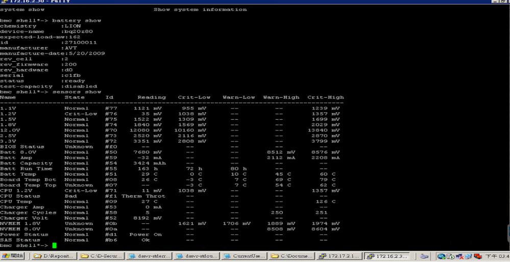

The BMC Shell command sensors show found that the CPU status is Bad
Does this situation mean that the controller needs to be replaced?

This likely needs addressed with HW replacement, as the indication for 1.2v to the CPU is well below the critical low threshold.
Please open a support case to have this addressed.
