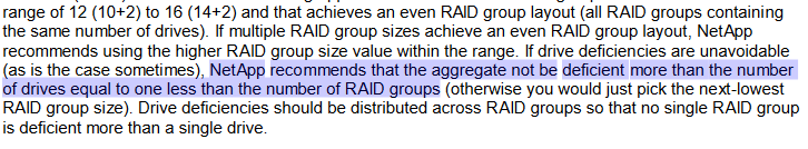

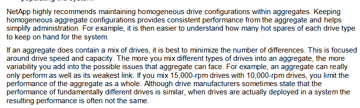

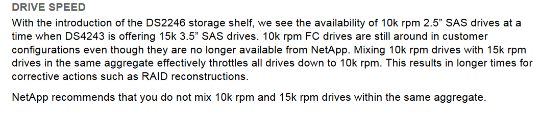

A few statements first:
https://www.netapp.com/us/media/tr-3838.pdf
Raid sizes (disk count difference)
https://www.netapp.com/us/media/tr-3437.pdf
Another thing that is not well documented is the different size - but easy to explain. the larger drives have double the amount of data on them. so they getting more read requests. (but i'm not sure how the write is distribute).
As you can see. your environment not comply with it....
As for how to resolve all of this. i think that you can't without destroying you main aggregate. but i don't know if you have spare capacity to move the data to. .
The bit of funny thing is that i don't think you will make it worse if you just add the 5 drives to the existing aggregate - you would likely actually make it better as you remove what i believe is the current bottleneck of hot raid-group. you better validate it with statit -b and statit -e on peak time to see if it's indeed the bottleneck.

Just a few minor points - as of ONTAP 9, we now say that the smallest RAID groups can be as small as half the size of other RAID groups (https://library.netapp.com/ecm/ecm_download_file/ECMLP2496263 - page 72), and as 15K drives are no longer available, we have had to supply 10K 600GB drives in LFF carriers as replacements for some systems, and have not had performance issues from it, so don't design to mix RPMs of similar disks, but it's not the end of the world if you have to.
