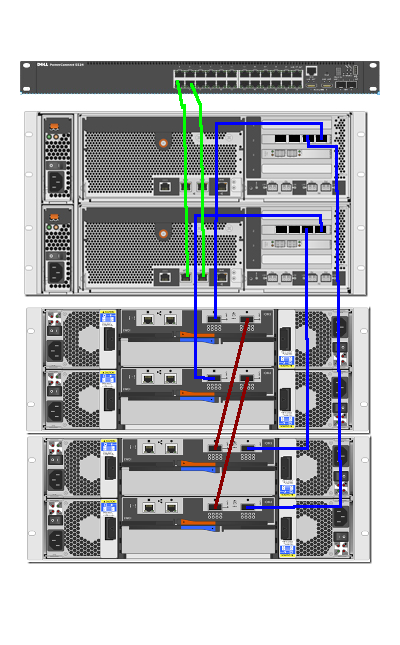

Can someone look at my wiring for the shelves.
I'm going off the cabling instructions from https://library.netapp.com/ecm/ecm_get_file/ECMM1280392
I chained the shelves with the SAS cables.
Then ran ethernet from all for ports up to the switch.
My e0M is run too but on a different subnet.
8.1.4 7-mode
Am I missing anything?
Thanks.

aborzenkov
4,765 Views
SAS shelves are never connected to the switch. They are daisy chained directly to private management ports on both controllers.
solvire
4,740 Views
Ok.
So I have the shelves connected to the controllers.
And then the controllers e0a e0b to the swtich. Not to the shelves.
Is that correct?
What is the preferred way of getting the netapp attached to my application servers? I am planning NFS over ethernet.
