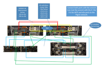

Here's the diagram I was given and referenced plugging it all back together. I can take an actual picture tomorrow as well. It was powered off for approximately 4 days as far as I can tell.
AlexDawson
5,011 Views
That looks correct.
