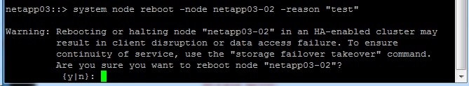

I have NetApp 2750 ONTAP 9.7 Cluster mode (two HA nodes: netapp03-01 and netapp03-02)
When running the command "system node reboot -node netapp03-02"
I get a warning: ... To ensure continuity of service, use the "storage failover takeover" command.
Should I run the command "storage failover takeover" before rebooting the node?
Indeed, in HA mode, the "failover takeover" operation should be performed automatically when a node is disconnected or lost. Is not it?

A takeover is a reboot of the node being taken over from. I'm not sure if this is the question.

Reboot will cause a panic mode takeover and wont be properly negotiated as it would had been when you run Storage failover which will reboot the node anyways .
I think best practice is if in Ha if you want to reboot node A .. do a takeover from node B there wont be future giveback issues

Thanks for the answer, I want to clarify.
The "storage failover takeover" command invokes the takeover of the node, then the node is rebooted, then a giveback automatic occurs?
So, for a scheduled reboot, is it enough to run "storage failover takeover" command only? I shouldn't be running the "system node reboot" command. Right?
Are "storage failover takeover" command and "takeover node" execution from GUI equivalent?

Yes to all, and the first question also depends on if the automatic giveback is enabled.

Automatic giveback is enabled, by default. You might have noticed that the GUI gives you an "Action" to disable automatic giveback.  This might be needed if you're not just rebooting the partner node - instead, you might need to be in control of when the giveback occurs.

yes you’re right you don’t have to do a node reboot if it’s scheduled . Do a storage failover takeover and then wait for auto giveback this will ensure your aggregates are properly taken over and properly given back
node reboot involves issues sometimes
