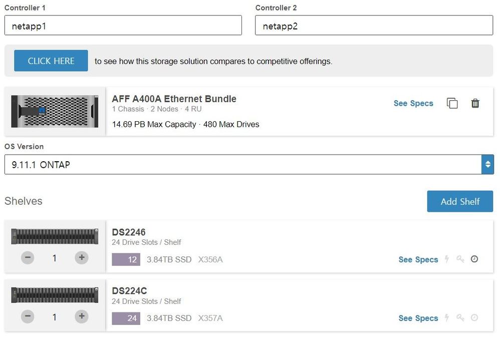

Hi, everyone here.
I'm asking you a question for advice.
I want to mix X357 and X356 as the title suggests.

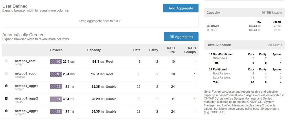

In Fusion tool, it is difficult to check because the Aggr pool is not configured with a mixture of disks.
I wonder if the above configuration is possible and the recommendation.
I would appreciate it if you could provide KB and docs data related to this.
Have a nice day.
Thank you.
