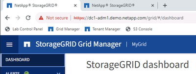

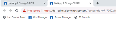

Just a follow up question on the global management certificate. The documentation states:
"Because a single custom management interface certificate is used for all Admin Nodes, you must specify the certificate as a wildcard or multi-domain certificate if clients need to verify the hostname when connecting to the Grid Manager and Tenant Manager. Define the custom certificate such that it matches all Admin Nodes in the grid."
What about the Tenant Manager? How do I configure its name and IP-address? If I click the Tenant Manager within StorageGrid Manager it takes me there, but I see no way to configure anything? Hence I cannot add this info in the managemt certificate. What did I miss here?

Your certificate should have every DNS entry clients will use to access that system.  The tenant management and Grid management UI login's are the same, the only difference is the tenant login page has "/?accountId=" appended to the end that does not need to be in the certificate. What will you be providing to the users as the URL to log into the system. this is what needs to be in the certificate. The same is true for your load balancer endpoint certificate. what ever you will be providing clients as the URL for S3 requests are the DNS entries that needs to be in that certificate.  Wild card entries are mainly for using virtual hosted style URLs vs path style.  You would need a wild card DNS entry for that to work as well.
To summarize, what ever DNS entries you have that you are going to provide to clients to access a component of the system need to be in the certificate installed on that component.
Santricity certificates are managed in Santricity.

Grid vs. Tenant TLS - these are commonly on the same FQDN/IP, but only you know if that's the case for you. In this screenshot, you can see FQDN of a Grid Admin endpoint:
And FQDN for Tenants is the same.
So you could have 3 DNS entries for one and the same virtual IP for admin:
admin.s3.company.corp
tenant1admin.s3.company.corp
tenant2admin.s3.company.corp
Now, each of these 3 admins could go to their "dedicated" FQDN but it'd be the same VIP and *.s3.company.corp would work okay. If you instead issued a cert for [admin,tenant1admin.tenant2admin].s3.company.corp, each of them would see these called out.
Although there's nothing "secret" about it (it's easy to reverse-query DNS and get all the hostnames), some prefer to use *.s3.company.corp - it obscures certain details and also frees them from having to maintain the TLS to add tenant3.s3.company.com when that tenant gets added.
You can find a Tenants tab in here:
https://docs.netapp.com/us-en/storagegrid-117/admin/using-storagegrid-security-certificates.html#platform-services-endpoint-certificate
It mentions certificates in the context of "platform services". Those are usually external services (Elasticsearch, etc.) used by the tenant, so not something you'd replace *on* StorageGRID.
