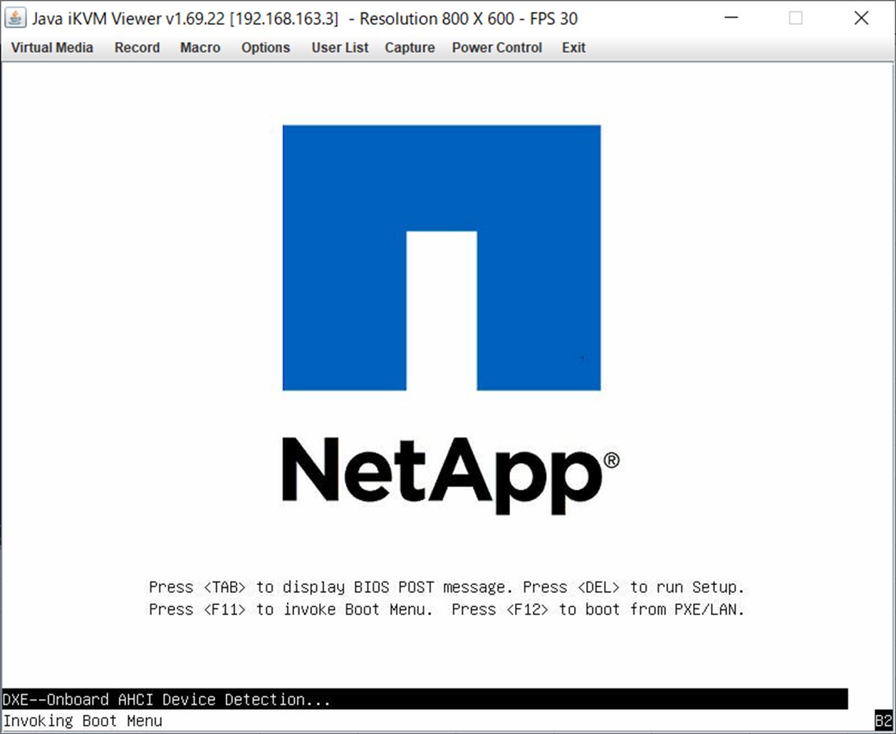

Hi,
I try to install HCI1.8P1 to H300S(H410S).
I prepared usb memory.(16GB)
I download Solidfire install (RTFI) image file from mysupport.netapp.com.
I make RTFI usb memory by etcher.

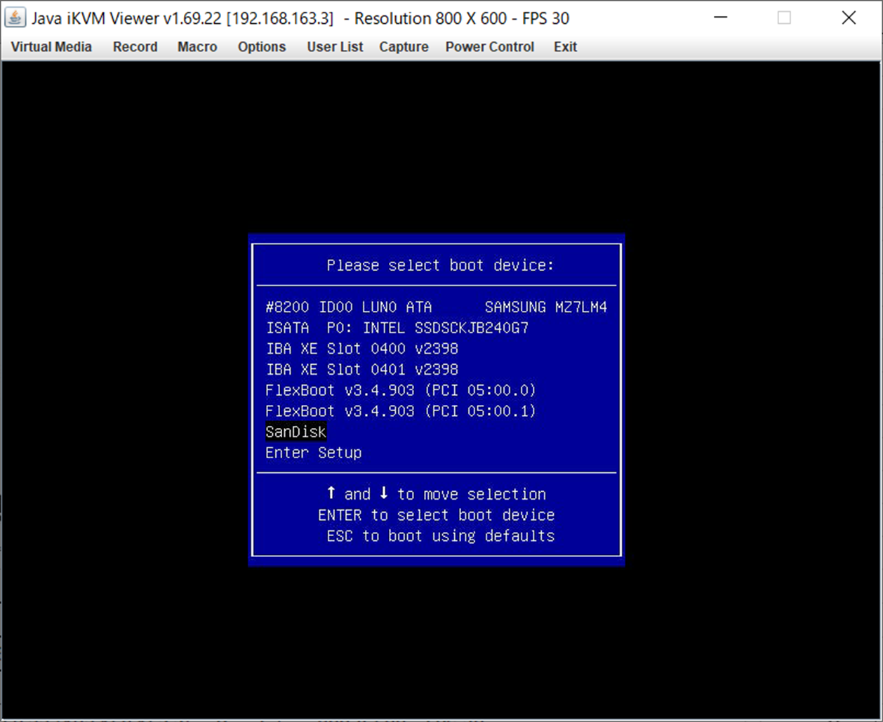

1.RTFI usb memory in to H300S and Power On.
2.Invoke Boot menu by F11 key.

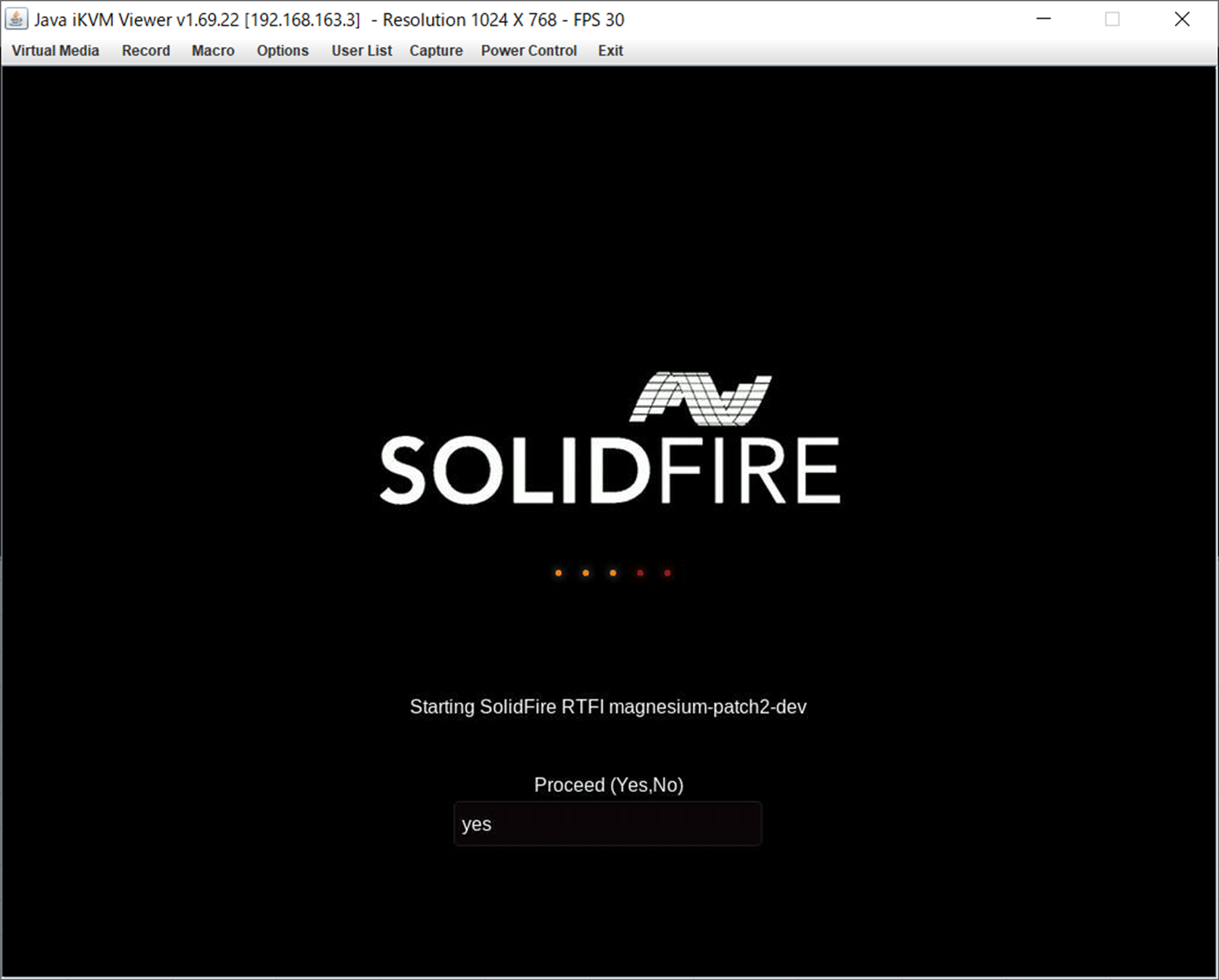

3.Solidfire logo image appeard.
[Starting SolidFire RTFI magnesium-patch2-dev]
type [ Yes ] and Enter.

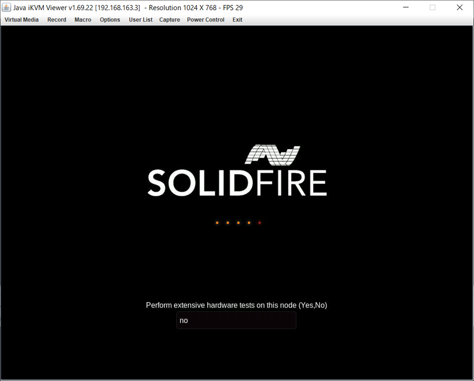

4.Perform extensive hardware tests on this node(Yes , no)
type [ no ] because I dont want to wait..

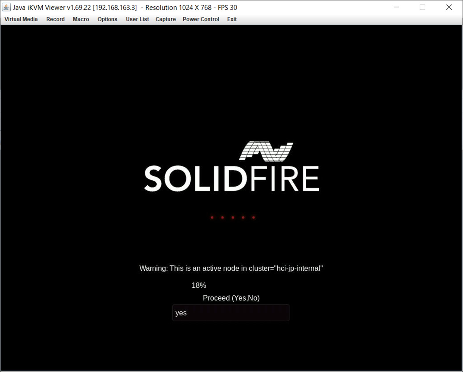

5.Waring: This is an active node in cluster = "hci-jp-internal"
Proceed (yes, no)
type [ Yes ] to continue.

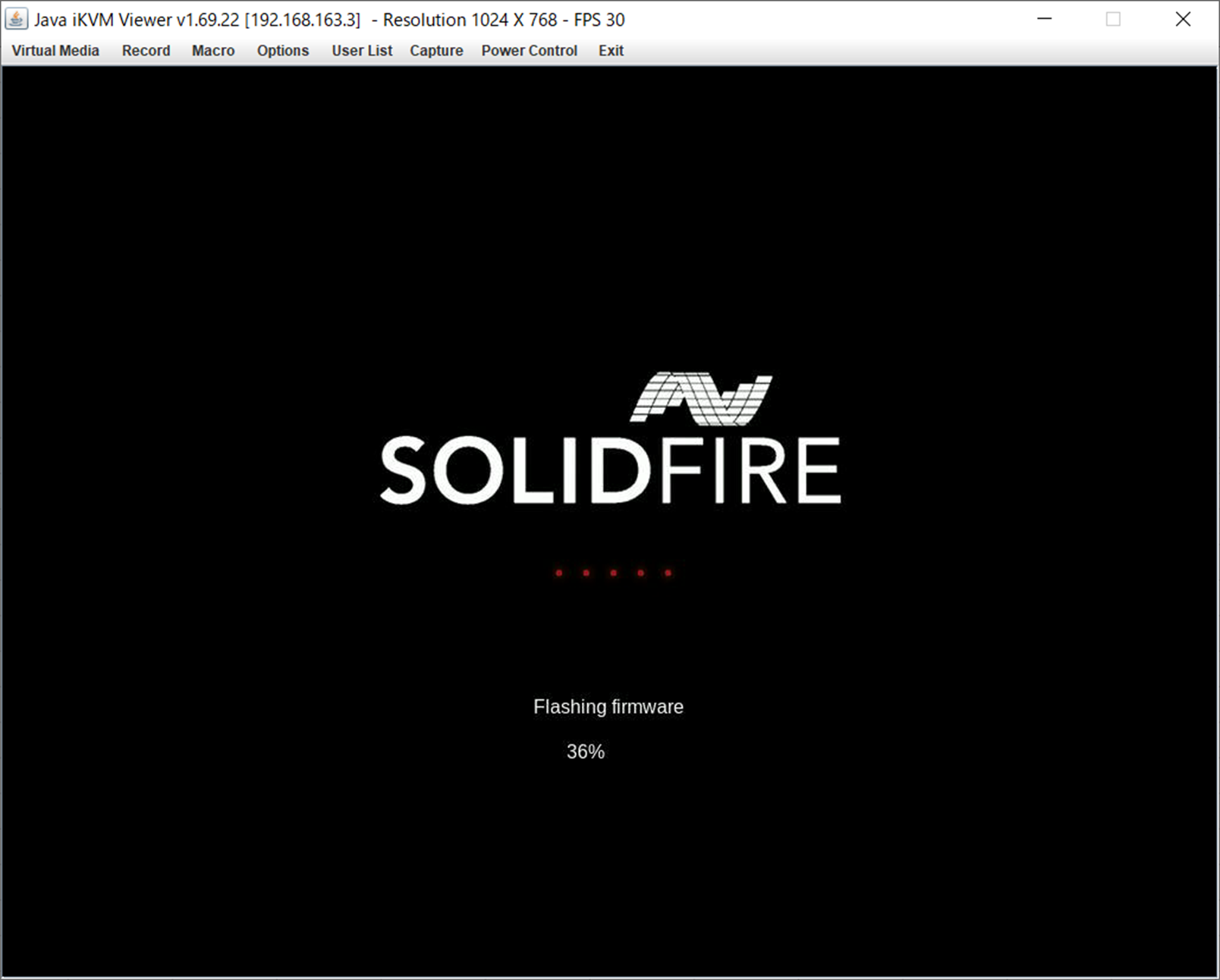

6. flashing firmware

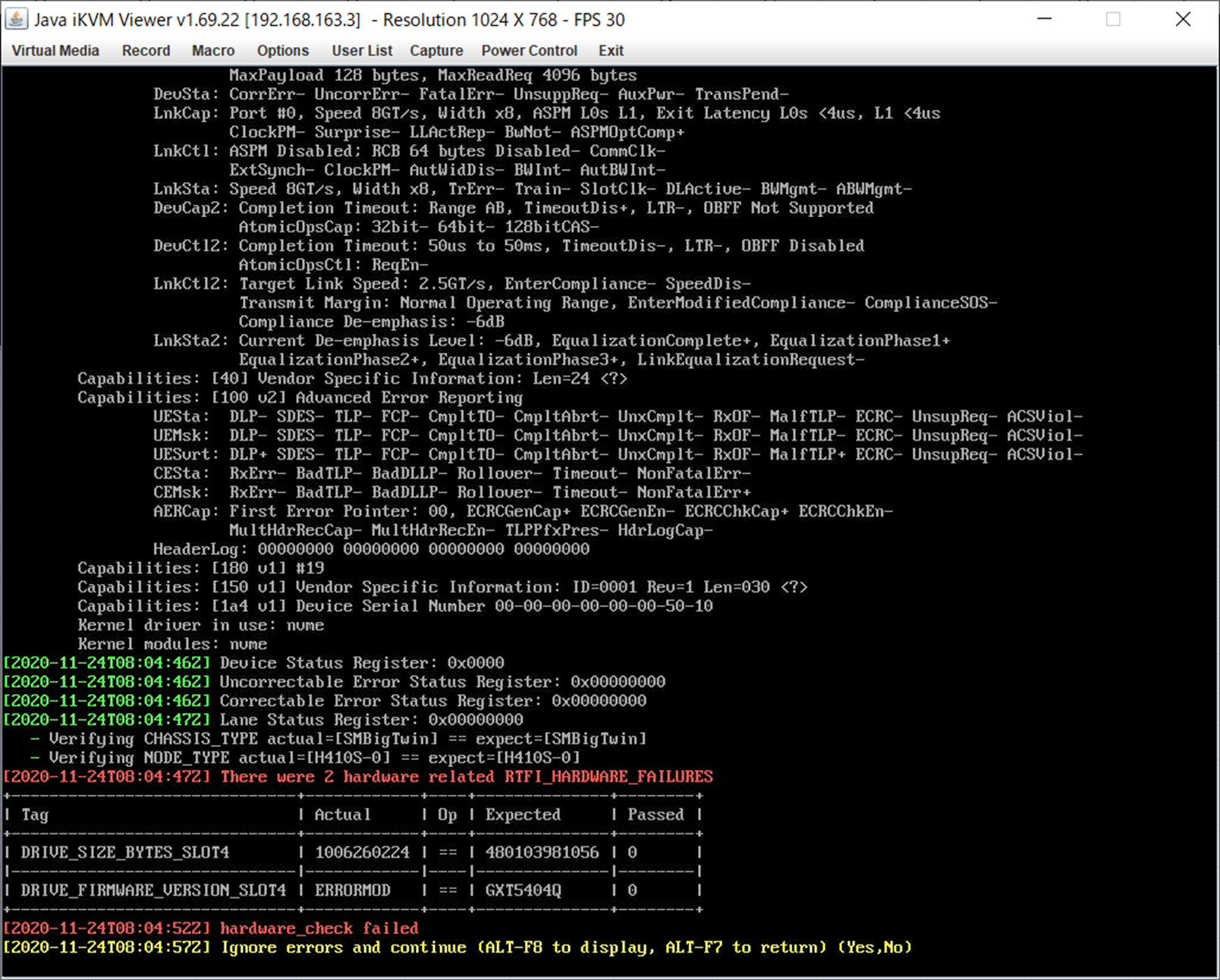

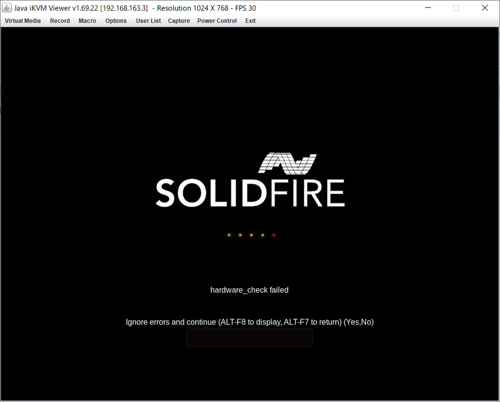

7.hardware_check failed.
Ingnore errors and continue( ALT-F8 to display, ALT-F7 to return) (Yes , No)
I insert [ ALT key and F8 key]
return [Alt + F7 ]
I chose [ yes ] and continue...
Is it correct?
If not good what do I have to do?

Hello SHINSASA,
It looks like the hardware test errors are reporting that the drive in Slot 4 has the incorrect size and invalid drive firmware. Something may be wrong with the drive, and it may need to be replaced.
After RTFIing the node, do you see any errors with the node or its drives in the Cluster UI?
It would be a good idea to open a support case to do an in depth investigation.

elementx
6,524 Views
No one said a disk failed.
The error message was hardware check failed (because unexpected firmware version was found on the disk).
From the screenshot it looks like you installed the cluster. If that's the case you can use the SolidFire API or PowerShell Tools to re-check disk firmware to see if it's been flushed in the process of installation.
